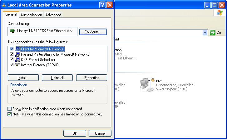

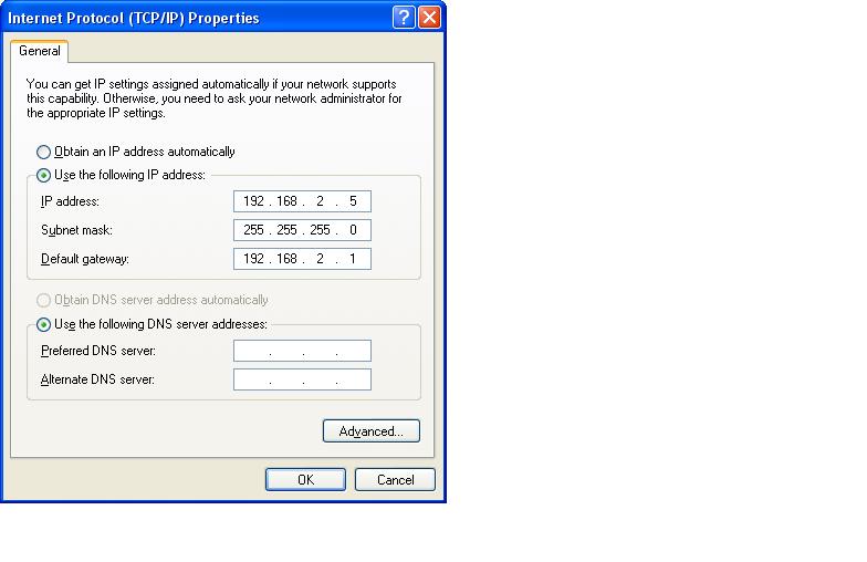

homecomputeraid Posted March 2, 2006 Report Share Posted March 2, 2006 [edit]As I typed all the following, something in the back of my mind kept asking if we really have to go through all of this. Why not eliminate the DI-604 and just use the Telephone router? Are you able to manage that and configure a port translation for your web server? It would be best to explore that possiblity further before embarking on the following, but if you want to just dive in, here's my proposal:Once you're able to get in to the DI-604, change the IP Address of the LAN, then assign a static IP Address to your laptop within that range, then change the DHCP Scope. I believe that once you change the IP Address of the LAN on the DI-604, you'll loose your connection to it until you change your PC's IP to one that's within the same range as the router's new IP. I'm going to recommend that you use the following scheme for your new LAN IP and DHCP Scope:LAN IP: 192.168.2.1 MASK: 255.255.255.0DHCP Starting IP: 192.168.2.100DHCP Ending IP: 192.168.2.199To change the router's LAN address, get into the management page, then click on LAN on the left. Type the new IP Address of 192.168.2.1 and you can leave the mask as it is if it's already 255.255.255.0, then click Apply. Don't be alarmed when you're unable to talk to the router after making this change.To change your IP to one that can communicate with your router on using its new IP, if you have Windows XP, click on Start, Control Panel, Network and Internet Connections, Network Connections. Right click on Local Area Connection and select Properties. The Local Area Connection Properties window will open:Click on TCP/IP then click on the Properties button. The Internet Protocol (TCP/IP) Properties window will open:Click the Use the Following IP Address radio button, then type an IP Address of 192.168.2.5, with a mask of 255.255.255.0, and a Default Gateway of 192.168.2.1. Click Ok, and Ok to exit the configuration screens, and try to open your router's management window again. You'll have to put its new IP Address of 192.168.2.1 in your browser's Address dialogue.Once you're in the router, click on DHCP on the left and put in a starting IP of 192.168.2.100, and an ending IP of 192.168.2.199. Click Apply. (The above router configuration information is on pages 18 and 19 of your DI-604 manual if you have a REV A, B, or C router). Get to the Internet Protocol (TCP/IP) Properties window as described above and re-enable DHCP by clicking the Obtain an IP Address Automatically radio button. Click Ok twice to save your changes. Your computer should now obtain its IP Address from your newly re-configured router.Get back to a management browser session on your router to make sure this was all completed successfully.After all of the above is complete and tested, I recommend configuring your network as follows:Internet --> Co-ax port on Cable Modem --> Ethernet port on Cable Modem --> WAN Port on DI-604 --> Switchport on DI-604 --> WAN Port on Linksys Telephone router --> Switchport on Linksys Telephone router --> your computer. (If the last switch to your room is necessary, please make sure you have a link light between it and an open switch port on the Telephone router (you'll need either a crossover cable, or a port designed to be used for uplink)). I'm kind of going port to port for you.Once everything's connected, I recommend powering it all off, then powering on from the Internet inward. Cable modem first, then DI-604, then Linksys. You'll want to make sure you get DNS Servers assigned when you get your DHCP Address. You can check this by going to a command prompt and typing IPCONFIG /ALL.If all of that's working, I'll have to try to figure out how to get the Internet traffic to your web server through two routers. Do you know what make and model the telephone router is? Quote Link to comment Share on other sites More sharing options...
