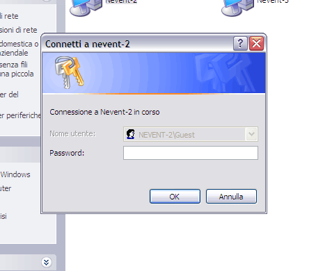

Sandro Posted May 22, 2006 Report Share Posted May 22, 2006 Hi there,I just reinstalled W XP, everything seems to be ok a part when a user try to login from another PC.The login form appears, but with the user field disabled and so, without any possibility to specify other username except for the Guest account, wich actually result be disabled.Attached you can see how this mask appears from other computers.Thanks in advance for any help. Quote Link to comment Share on other sites More sharing options...

cozofdeath Posted May 23, 2006 Report Share Posted May 23, 2006 Try thisYou probably have the anonymous logon enabled and by default it takes only the 'Guest' user. You need to edit some settings on the machine you are connecting to...Start -> Run -> secpol.mscGoto Security settings -> Local Policies --> Security optionsFor the policy 'Network access:Sharing and security model for local accounts' change the security setting to 'Classic'Save the settings Quote Link to comment Share on other sites More sharing options...
Sandro Posted May 25, 2006 Author Report Share Posted May 25, 2006 thank you very much for your help.Now it ask me the username. The only thing is that from the remote computer I can't see the shared docs folder. Normally is displayed without any modify in the shared settings.Have you any suggestion about it?Thanks again. :D Quote Link to comment Share on other sites More sharing options...
