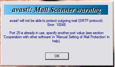

Guest LB Posted August 16, 2003 Report Share Posted August 16, 2003 i have taken redhats advice and installed Avast anti-virus, it actually had alot to do with not being to get the updates from AVG but anyway, all installed ok but when restarting i get the message shown below.....I have read the help message advised but am more than a little confused.....any help that could be offered would be gratefully accepted. Quote Link to comment Share on other sites More sharing options...

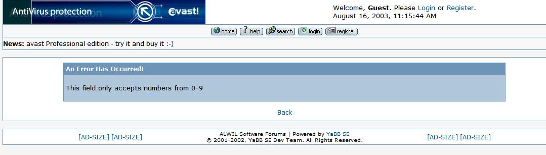

Guest LB Posted August 16, 2003 Report Share Posted August 16, 2003 this any help??http://www.avast.com/forum/index.php?action=search2just gives me an error message...... Quote Link to comment Share on other sites More sharing options...
Guest Nellie2 Posted August 16, 2003 Report Share Posted August 16, 2003 Oh....... that's weird.Try this then http://www.avast.com/forum/index.php?board...did=498;start=0This is what it says anyway;Error 10048 on ashmaisv.exe« on: June 17, 2003, 09:39:58 AM » --------------------------------------------------------------------------------I've installed Avast 4 home on my PCI use Win XP pro SP1, Zonealarm 3.7.143, Outlook express 6.1, incredimail and popeeper.When I start windows, I'm unable to read my e-mail.I've tried closing Zonealarm, but the only way I can, is stopping and starting many times Ashmaisv.exeIn the ashmaisv.log ther is the seguent line :Cannot start SMTP listening thread. Error 10048(0x00002740)every time i tried to read my e-mailCan anyone give me a solution ?robimo Report to moderator Logged vojtechALWIL teamFull Member OfflineGender: Posts: 90 Re:Error 10048 on ashmaisv.exe« Reply #1 on: June 18, 2003, 08:00:19 AM » --------------------------------------------------------------------------------You need to specify another port for avast! SMTP listener (e.g. 26). Add this line to file C:\Program Files\ALWIL Software\Avast4\Data\Avast4.ini into section [MailScanner]:SmtpListen=127.0.0.1:26Then stop and start ashMaiSv.exe. Set the same port value for outgoing mail in account settings in your mail program.What is the problem with incoming mail ? Report to moderator Logged robimoNewbie OfflinePosts: 2I'm a llama! Re:Error 10048 on ashmaisv.exe« Reply #2 on: June 19, 2003, 06:33:54 AM » --------------------------------------------------------------------------------Thanks. I've changed the Pop3 port to 115 and it's Ok!Robimo Quote Link to comment Share on other sites More sharing options...
Guest LB Posted August 16, 2003 Report Share Posted August 16, 2003 nellie, you are not just a pretty face....many thanks all is now sorted and no error message!!!!! Quote Link to comment Share on other sites More sharing options...
