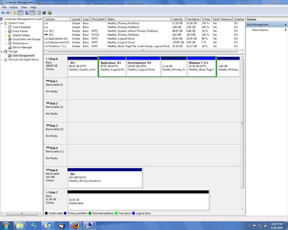

dale_nx26 Posted May 29, 2009 Report Share Posted May 29, 2009 My hard drive is (or rather was) a Maxtor with 200GB. Now my computers can only read 31GB on it. I tried disk management reformatting and error-checking but none works to gain back my space. I tried to google search it but don't exactly know what to search for. What happened and can I fix it? Thanks in advance! Quote Link to comment Share on other sites More sharing options...
ɹəuəllıʍ ʇɐb Posted May 29, 2009 Report Share Posted May 29, 2009 Not quite clear what the problem is. Can you show us a screen shot (as the example below) of your disk layout (compmgmt.msc) ? Quote Link to comment Share on other sites More sharing options...
dale_nx26 Posted May 29, 2009 Author Report Share Posted May 29, 2009 Not quite clear what the problem is. Can you show us a screen shot (as the example below) of your disk layout (compmgmt.msc) ?yup. here ya go. sorry i couldnt make it sharper.the disk in question is disc 7 (31.5GB) Quote Link to comment Share on other sites More sharing options...
dale_nx26 Posted June 13, 2009 Author Report Share Posted June 13, 2009 HAHA!!! All this happened because my HDD (PATA) cable was faulty! With a new cable, my PC is now able to detect all the spaces. Yes! This also explained why I wasn't able to detect my other HDD nor could I use it with my SATA HDD. All is well now. Thanks for the reply. Quote Link to comment Share on other sites More sharing options...
