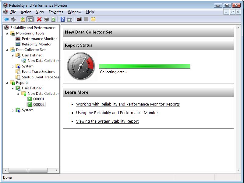

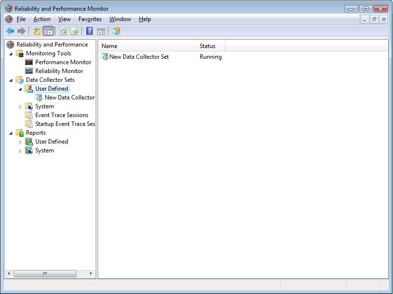

josepha Posted October 20, 2011 Report Share Posted October 20, 2011 Hello, I am using Reliability & Performance Monitor Utility (perfmon), to Record my bandwidth usage, but i have a problem with this utility reports. Note: When i use "perfmon" to monitor the bandwidth, it works Correctly (the problem is when i record it) I did Define a Data Collector Set, and this Collector start Recording, and as I notes that you cant check your report until you stop the collector. The Problem is; that report is always empty, what ever i added to the collector. These are my steps: (I am using win vista):1. perfmon.exe2. Data Collector Sets > User Defined > Right-click > new data collector set3. Create manually > create data logs > Check Performance counter4. Add > Network interfaces > " I click on <all instances> to make sure that i don't miss the right adapter.5. click Add >> Press Ok.6. Next > Finish. The Collector status is "Running", and the report status is"Collecting Data" ..but after i stop the collector, the report appears Empty. !! Any ideas ? is this utility really so such reports ? do I am Missed some thing ! thanks, Quote Link to comment Share on other sites More sharing options...
Makcalable Posted October 20, 2011 Report Share Posted October 20, 2011 perfmon /report isn't reliable for collecting data for bandwidth and really shouldn't be used for doing so IMO I don't know of anyone that uses the performance report for bandwidth data. To monitor your Bandwidth you should try this, NetWorx – Free Bandwidth Monitoring and Usage Reporting See Here Quote Link to comment Share on other sites More sharing options...
