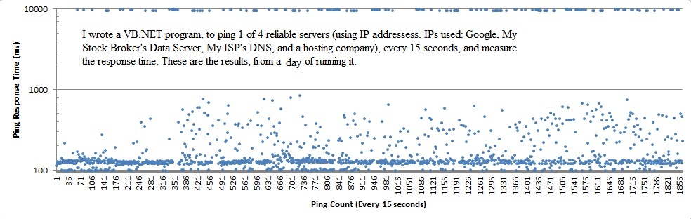

I'm getting only ~90% of ping responses (inside of 10 seconds). But, not all the time. See attached.

post-22473-0-81314700-1329709750_thumb.j
