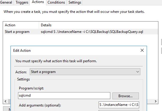

sqlcmd -S .\InstanceName -i C:\SQLBackup\SQLBackupQuery.sql (backup query file location and file name)

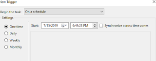

If you require it to schedule the Process for backup of all SQL databases on the path where you want You can schedule it from Task Scheduler.
To create a task go to Run (windows +R) - taskschd.msc and create a task.  schedule it as per the requirement.
Here define the action.
Note- User should have the Admin right,Logon as batch Job Right. You also can automate on SQL Server Express from above query and Process.
