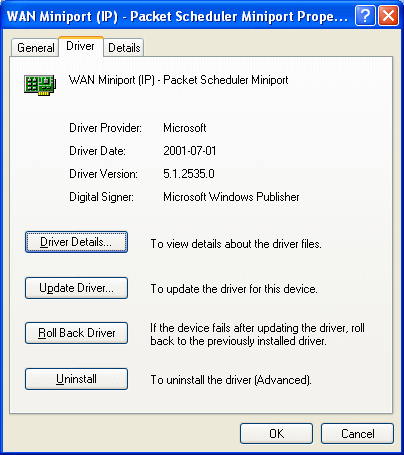

ɹəuəllıʍ ʇɐb Posted February 8, 2005 Report Share Posted February 8, 2005 I have something called "WAN Miniport (IP) - Packet Scheduler Miniport" in my Device Manager, with the cute little yellow exclamation mark on it.Had it since the beginning, and still have it with SP2. Here's the message from the driverI would love to unistall it, but I can't. Windows won't let me, not even in Safe Mode. It saysSince it doesn't work anyway, how can I get rid of it? (The driver, b.t.w., is called psched.sys; and it's there, at C:\Windows\system32\DRIVERS, not damaged, and the newest SP2 version).P.S. what is it used for? Quote Link to comment Share on other sites More sharing options...

ɹəuəllıʍ ʇɐb Posted February 9, 2005 Author Report Share Posted February 9, 2005 I don't know when that thing actually got installed - I think it was not with the original XP installtion, but some software that I added later. But no recollection what it was.One strange thing is that on the Driver panel it says Driver Version 5.1.2535.0... but the actual driver file psched.sys is version 5.1.2600.2180 (SP2). There are no newer driver files available.Is is really not a very terrible thing; it's just that every time I open the Device Manager I think that I must do something about this. I think I will start looking in the registry for clues. Quote Link to comment Share on other sites More sharing options...
