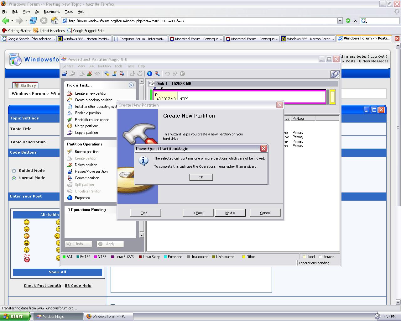

benb Posted February 21, 2005 Report Share Posted February 21, 2005 Hello,I'm not sure where this post should go, so if it's in the wrong place, admins please move it. My problem is that I am trying to install a new operating system using Powerquest PartitionMagic 8. When I press next in the new OS wizard, an error message, "The selected disk contains one or more partitions which cannot be moved. To complete the task use the Operations menu rather than a wizard" pops up. I have a Dell Dimension 8400 with a 160 gig HD. PM shows me 4 partitions, "DELLUTILITY (*.) FAT", "Local Disk (C:\) NTFS", "(*) Unallocated", and "Local Disk (*.). I should only have, or shall I say, only use one partition, the main C:\. Anybody know what is causing this? Screenshot attached. Quote Link to comment Share on other sites More sharing options...

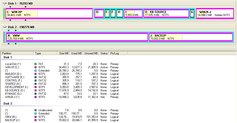

ɹəuəllıʍ ʇɐb Posted February 21, 2005 Report Share Posted February 21, 2005 Your post is perfectly fine here :)First a question (it is a bit difficult to see exactly what you were trying to do from the screenshot): were you trying to create a primary (bootable) partition, or a secondary data partition?If you were creating a secondary partition, you must first create an "extended partition", which in turn can contain a number of "real" secondary partitions. These can then be addressed with drive letters, such as D:.See here for a snapshot of my HD layout.The pink partitions WIN-XP and WIN2K-J are bootable primary partitions.The light blue partitions are extended partitions that contain multiple logical secondary partitions.Now in your case it appears as if you had only one large primary partition. You need first to resize that partition to make room for an additional primary or extended partition.Make sure that you defrag your current C: drive first.Also, if you have any important data on your disk, be sure to backup them beforehand. Partition Magic is usually safe, but as -pops- wrote in the other thread, things may and will sometimes go wrong. Quote Link to comment Share on other sites More sharing options...
ɹəuəllıʍ ʇɐb Posted February 21, 2005 Report Share Posted February 21, 2005 Re-reading your post I understand now that you need a new primary partition (new OS).Resize your current partition into roughly half (or whatever you'll need - you can always resize again later), then create a new primary partition in the empty space. To install the new OS, hide your current C: drive and reboot. You will see your new partition as an empty C: drive.If you use BootMagic as boot manager, you will not see the other C: drive when booted into one or the other. I usually create one or more shared data partitions that both systems can see. (That also is something you can add later if the need arises).P.S. [added] if you do not want to use BootMagic but Windows' own boot manager, then you don't hide the C: drive. Windows installer will then recognize the empty partition and install it there. In this case, both partitions will be visible all the time.But I do not know what new OS you want to install, so this PS is mere speculation. Quote Link to comment Share on other sites More sharing options...
benb Posted February 21, 2005 Author Report Share Posted February 21, 2005 I am trying to install Linux, and I don't have BootMagic, although it doesn't matter because Linux comes with bootloader. Thanks for the quick reply :) Part of my problem though is that it won't let me resize the partition. It does the same error-like thing that is shown in the screenshot. After some Googling, I believe that PM limits you to 4 partitions on one HD (is this correct?). Also what do you mean by "hide the C:\ drive"? On the note of backup, I went out a got some DVD+RW today... Thanks for all the help. Quote Link to comment Share on other sites More sharing options...
benb Posted February 21, 2005 Author Report Share Posted February 21, 2005 Turns out I am a complete idiot.... heh heh. Anyways I was clicking on the graphical representation of C:\, not the text below. Now it will let me resize... Say I only give Windows 20 gigs, and Linux 120, and say Windows runs out of space, could I give part of the Linux partition (unused space of course) to Windows pretty much hassel-free? Quote Link to comment Share on other sites More sharing options...
