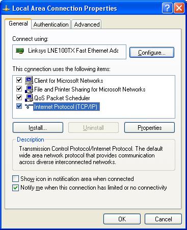

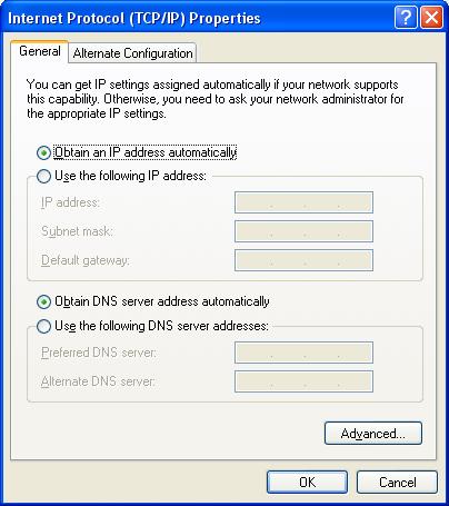

homecomputeraid Posted March 5, 2005 Report Share Posted March 5, 2005 I've never used Internet Connection Sharing myself, but you can set it up as outlined in this article http://www.microsoft.com/windowsxp/using/n...rnmore/ics.mspx on fei-d, then have your laptop obtain its IP Address automatically by going to Start, Control Panel, and in Control Panel, double click Network Connections. Right click on the local area connection you want to modify and select Properties. The Local Area Connection Properties will open up:Highlight TCP/IP by clicking on it, then select Properties. The Internet Protocol (TCP/IP) Properties window will open:Click Obtain IP Address Automatically and Obtain DNS Automatically. From the Article I'm sending, I did not see DHCP addressed directly, but I believe Internet Connection Sharing (ICS) will provide the address for your laptop. Please post if it does not work. Quote Link to comment Share on other sites More sharing options...
