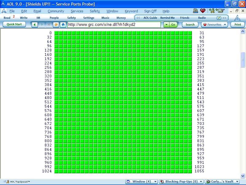

CurlyWhirly Posted March 30, 2005 Report Share Posted March 30, 2005 I have run the Shields Up test at Click here, and according to the test all of the ports are in Stealth Mode (See screenshot) I know that there are 3 possible states for a port, on, off or stealth. I was always lead to believe that it is impossible to be invisible on the internet, as without displaying your IP address, no one would be able to communicate with you as this information is fundamental to the way the internet works, or have I missed something here? :unsure: Quote Link to comment Share on other sites More sharing options...
homecomputeraid Posted March 30, 2005 Report Share Posted March 30, 2005 Hi CurlyWhirley,Your assumption that your Internet IP can't be invisible is not necessarily correct. A properly configured firewall without any need for any static mappings (a DNS Server or E-mail Server, for example) can be made invisible to outside requests. That means unsolicited packets (pieces of Internet traffic) hitting your outside interface will not receive interaction of any kind from the firewall. They will all be silently dropped, which would mimic the results of a port scan to an IP with nothing attached to it.If your PC wants to go to the Internet, the return traffic from the server you're hitting is allowed back through the firewall because you requested it. It's kind of like a check valve, but it selectively lets some traffic (traffic you specifically requested) return.Hope that answers your question. Excellent results on ShieldsUp! :) Did you ask for All Service Ports or Common Ports? Quote Link to comment Share on other sites More sharing options...
CurlyWhirly Posted March 30, 2005 Author Report Share Posted March 30, 2005 Hope that answers your question. Excellent results on ShieldsUp! :) Did you ask for All Service Ports or Common Ports?Thanks for replying homecomputeraid Yes your reply does indeed answer my query.By the way, I used the All Service Ports option :) Quote Link to comment Share on other sites More sharing options...
