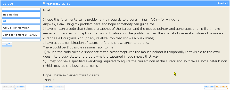

leojose Posted May 3, 2005 Report Share Posted May 3, 2005 Hi all,I hope this forum entertains problems with regards to programming in VC++ for windows.Anyway, I am listing my problem here and hope somebody can guide me.I have written a code that takes a snapshot of the Screen and the mouse pointer and generates a .bmp file. I have managed to succesfully capture the cursor location but the problem is that the snapshot generated shows the mouse cursor as a Hourglass icon (or any relative icon that shows a busy state).I have used a combination of GetIconInfo and DrawIconEx to do this.There could be 2 possible reasons (acc. to me)1) WHen the code takes a snapshot of the screen/captures the mouse pointer it temporarily (not visible to the eye) goes into a busy state and that is why the captured image shows that way2) I may not have specified everything required to aquire the correct icon of the cursor and so it takes some default icon (which may be the busy state icon).Hope I have explained myself clearly...Thanks Quote Link to comment Share on other sites More sharing options...
