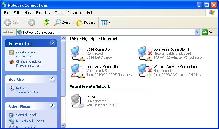

A quick fix to this for you is to uncheck "Use default gateway on remote network" in your TCP/IP Properties for the VPN Connection. To do this, right click on My Network Places, then click on Properties from the menu that appears.
The Network Connections window will open:

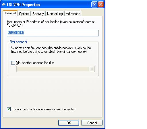

In the Network Connections window, find your VPN connection and right click it, then select Properties from that menu.
The VPN Properties window will open:

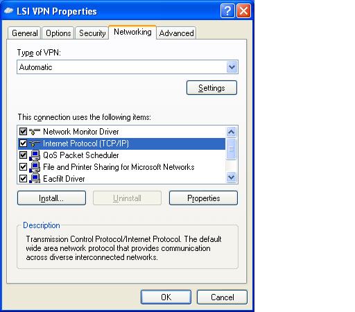

Click on the Networking Tab, and highlite Internet Protocol (TCP/IP):

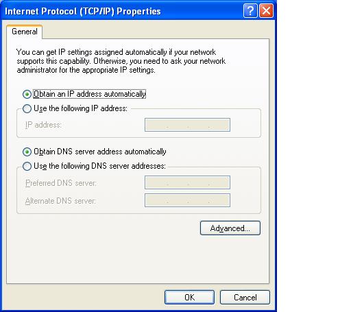

Click on Properties and the Internet Protocol (TCP/IP) Properties window will open:

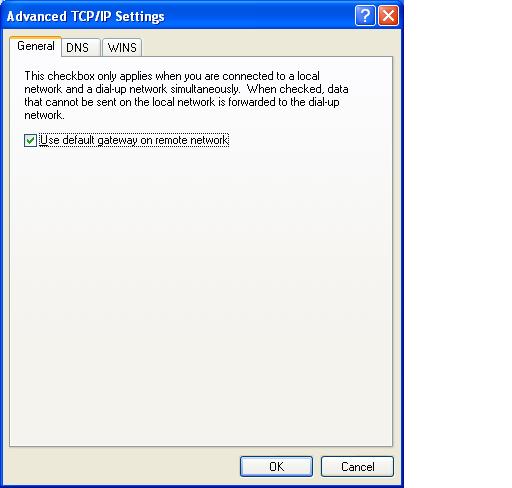

Click on the Advanced button and the Advanced (TCP/IP) Settings window will open:
Uncheck Use default gateway on remote network. Click Ok in all windows to finish setting. Try it again and let us know if it's fixed.
