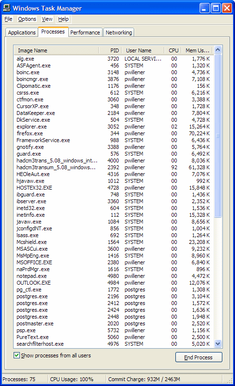

phinix Posted May 28, 2006 Report Share Posted May 28, 2006 i have made my own .exe files that i want to run as SYSTEM files.well you see every time we open the task manager/prosessora list apears. that list shows all the applications/prgrammes running at that movement. many of which are "userfiles" and many of which are SYSTEM files that runs atomaticaly when the computer starts.the thing is that i have made an .exe file which i want to run as SYSTEM file. how do i do that? Quote Link to comment Share on other sites More sharing options...

ɹəuəllıʍ ʇɐb Posted May 29, 2006 Report Share Posted May 29, 2006 I think what the poster really wants to know is how to start a process as 'system' user, as opposed to 'user' user.Not sure about this, but I think that you can only start a process under the 'system' user when starting it as a service. I have never seen any "normal" process running under the 'system' user. Quote Link to comment Share on other sites More sharing options...

cozofdeath Posted May 29, 2006 Report Share Posted May 29, 2006 Yeah why would you want that? If anyone could run anything as the local system account that would be bad, very bad. However most of the time you can run schedular from the command prompt and start a program in the system account. Their is also a 3rd party app that will let you do this locally and remotely as well, its at sysinternals.com. Quote Link to comment Share on other sites More sharing options...
