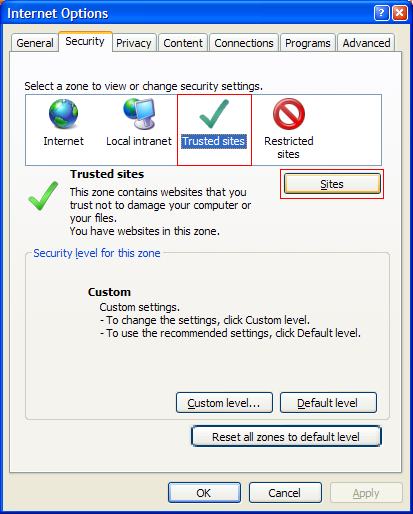

Click Tools > Internet Options > Security
Select "Trusted Sites"
Click "Sites"

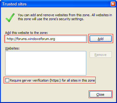

Uncheck the https option at the bottom of the dialog.
Add http://forums.windowsforum.org
Click Close.
Exit out of Internet Options, and you are done!
