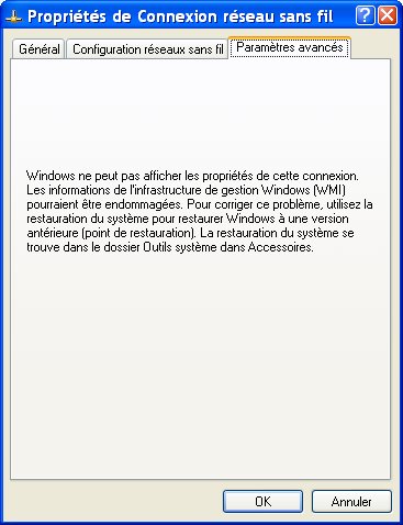

livevil Posted October 14, 2006 Author Report Share Posted October 14, 2006 I removed NAV to check for changes. The crash still occurs but I discovered something else: when I try to access to the advanced parameters of the network connections (where it is usually said that firewall is/is not enable), I got a message: "Windows cannot display the Properties of this connection. The Windows Management Instrumentation (WMI) information might be corrupted...."To solve this problem, microsoft tells to come back to an early backup point (which I haven't) or to restore using the install CDs (which I can't since XP was preinstalled).Do you think this could explain my problem ? Quote Link to comment Share on other sites More sharing options...
