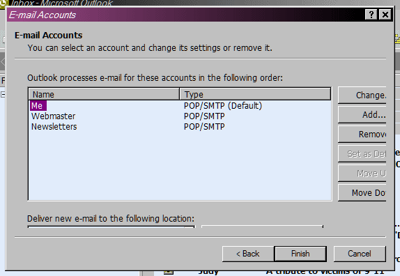

Full dialog not showing
SmokingMan
What happens if you revert to your original screen resolution?
If it's OK at that, it indicates that the system isn't capable of rendering the new resolution. There could be a number of reasons for this - most beyond my understanding.
I changed the resolution back to 800 x 600 and the problem went away. But there is a bit of a wrinkle here. When I changed again back to 1024 x 768 it worked fine. The problem seems to be in the DPI settings. While at the higher resolution, I had set the DPI settings to 110% to help my aged eyes read better. That seems to be where the problem originates. When I use the 96 DPI setting, dialogs display correctly. Anything larger than a 110% DPI setting is just too large.
So unless someone has any ideas, I guess I'm just going to have to choose between the smaller font at the higher resolution or go back to 800 x 600. But the lower resolution just doesn't look right on a 20" monitor. :censored:
