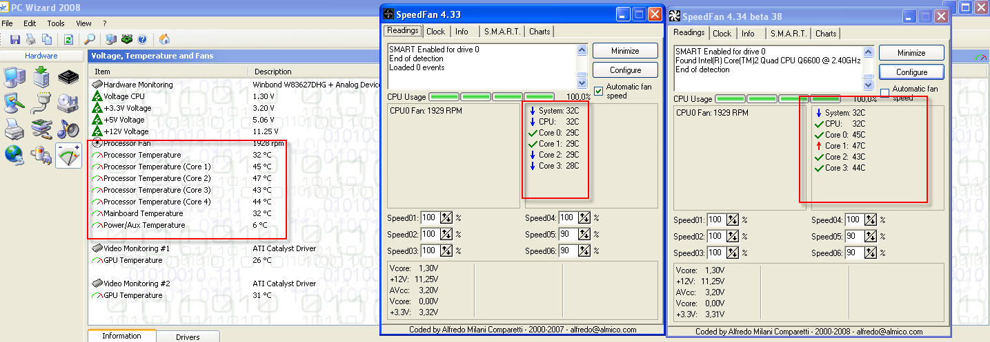

AlanHo Posted February 21, 2008 Author Report Share Posted February 21, 2008 your temps on prime are good indeed.There has been a development which has left me a bit concerned. I downloaded the new beta version of Speedfan and ran them both side-by-side. The beta version gives temperature readings 15C higher than version 4.33. I then downloaded and ran a programme called Core Temp - this tends to agree with the beta version of Speedfan.Here are screen shots of the 3 programmes with the computer idling - CPU at 15% . See next post for screenshot of temps at full load. Quote Link to comment Share on other sites More sharing options...

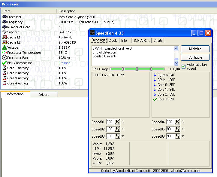

AlanHo Posted February 21, 2008 Author Report Share Posted February 21, 2008 Here are screen shots of the 3 programmes with the computer at full load - CPU at 100% .My dilemma now is - what do I believe and do I have a cooling problem. Quote Link to comment Share on other sites More sharing options...
Gagaman Posted February 21, 2008 Report Share Posted February 21, 2008 I did the test you did on my puter. Also a significant difference...Don't know really which is right... The new speedfan is beta so, there could be some glitches. On the other hand, pcwizard 2008 confirms these temps... EDIT: nevertheless, none of these temps should be very worrying. Depending on which core stepping you have, max. temps for the Q6600 are 71°C (GO stepping) or 62.2°C(B3 stepping). According to your coretemp information, you have a GO stepping.Source:http://processorfinder.intel.com/details.aspx?sSpec=SLACRhttp://processorfinder.intel.com/details.aspx?sSpec=SL9UM Quote Link to comment Share on other sites More sharing options...

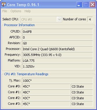

Gagaman Posted February 21, 2008 Report Share Posted February 21, 2008 I also dl. Core Temp, this are my temps on 100% cpu load:Seems the speedfan beta is monitoring the temps far better than the not-beta version... Quote Link to comment Share on other sites More sharing options...
Raddy Posted March 18, 2008 Report Share Posted March 18, 2008 Speedfan is off by 15C for C2Q's, I'm not actually sure why. You can create a 15 degree offset manually in the configuration, or you can use a program like CoreTemp. I discovered it when my air-cooled, overclocked Q6600 was running about 10F cooler than room temperature B) Quote Link to comment Share on other sites More sharing options...
AlanHo Posted March 18, 2008 Author Report Share Posted March 18, 2008 Speedfan is off by 15C for C2Q's, I'm not actually sure why. You can create a 15 degree offset manually in the configuration, or you can use a program like CoreTemp. I discovered it when my air-cooled, overclocked Q6600 was running about 10F cooler than room temperature B)Thanks for the confirmation - like you I eventually came to the conclusion that Speedfan was 15 degrees out on my computer and set the offset accordingly. I too have Coretemp om my computer but prefer Speedfan because I have a sidebar gadget in Vista that continually displays the selected Speedfan data. Coretemp displays the info it in the task bar - but the text colours are unfortunate and do not show too clearly. Quote Link to comment Share on other sites More sharing options...
