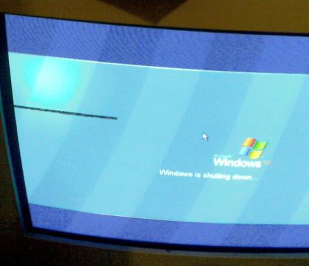

corupted img file on startup/hibernate
Ralph
Presumably this is a lmachine - with hibernation enabled ?
Try starting in Safe Mode (Press F8 when booting).
If that works -
When you eventually get a desktop visible - right click on it and then left click "Properties"
Select the Screensaver tab.
Left click "Power".
Left click the "Hibernate" tab.
Untick "Enable hibernation"
Click OK
Click Apply
Reboot.
If that clears the problem ............. then you can then re-enable hibernation.
If not ?????
