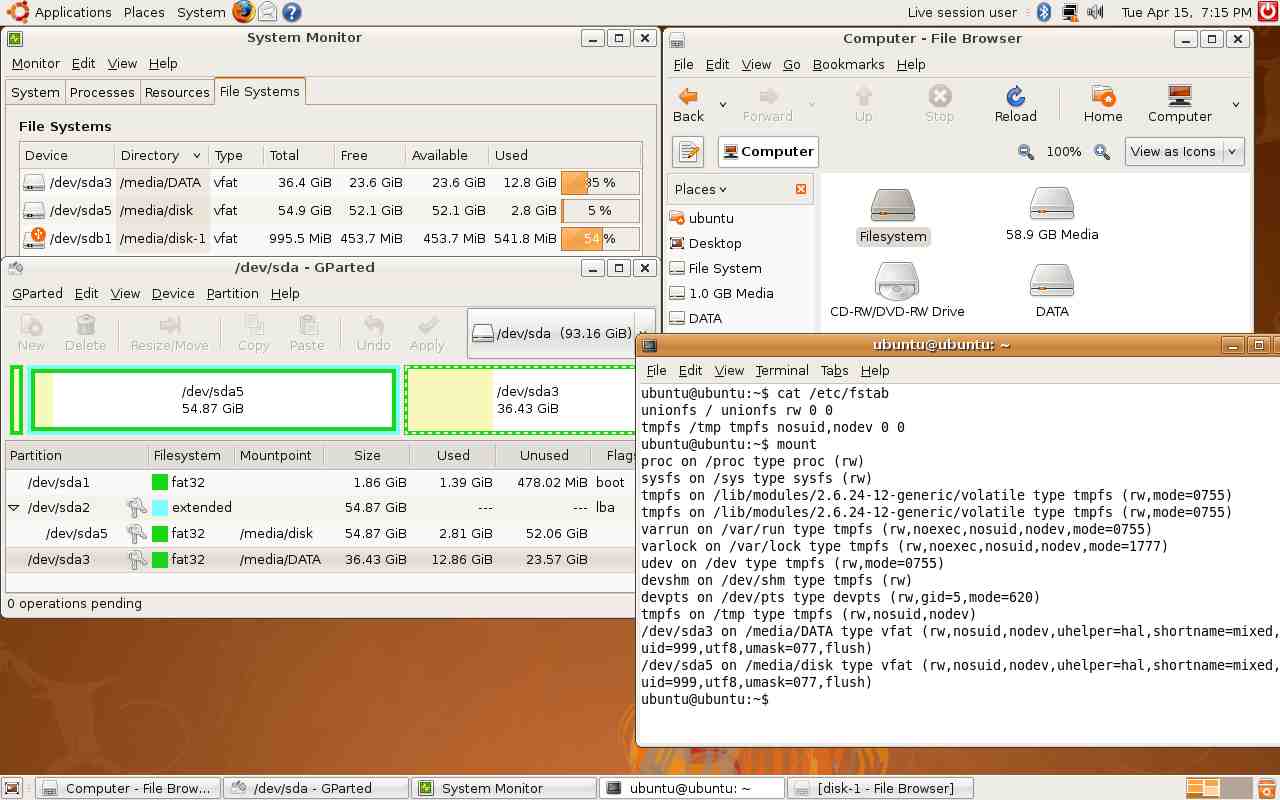

sauli Posted April 15, 2008 Author Report Share Posted April 15, 2008 Well, the NTFS formatting didn't complete due to yet an other shut down.But the try was not totally in vain. At boot the PC now did recognize the hdd recovery. It selected the hdd recovery options as if I had pressed F9 which I didn't. Obviously the boot sector got repaired in my failed WIndows recovery.I did try to do the recovery from hdd, I selected the option to do the recovery on the first hdd partition only. The recovery program did complete everything but the recovery was not good after all. Booting to Windows didn't proceed more than couple of seconds after which it restarted, restarted ... I guess that the interrupted NTFS formatting may have messed the hdd partition.I decided to take a look at the hdd partition by running the Ubuntu Live CD. In Gparted I can see three fat32 (vfat) partitions, the 1,9GB recovery, the 55GB WIndows partiton and the 36GB Ubuntu partition. I could browse the Windows partions and I didn't notice anything obviously broken there. I attached a screenshot about the GParted, System Monitor, File Browser displays as well as listing of /etc/fstab file and mount command output.I tend to believe that I'm waisting my and your time with this problem. Troubleshooting the Windows problems is too time consuming. I will install the Ubuntu + Wine on the laptop and see how well it works. But that has to wait a couple of days now.Thx for your help. It didn't solve my problem but taught me valuable things. In case you do get new ideas feel free to give them. I will come and check the site and if nothing else is broken in my electronic devices - which I doubt - I may give the Windows one more try. Quote Link to comment Share on other sites More sharing options...
Alan2273 Posted April 15, 2008 Report Share Posted April 15, 2008 Looking at your G-Parted picture , I am not sure what you have done.I see you have a SATA drive, but on looking at the partitions the native one for Windows should be NTFS not Fat 32 and your Ubuntu partition should be ext3 and there is no swap patition either.Just one more suggestion, as you have an OEM Cd, have you tried a Windows repair, there is an excellent guide on how to do it at this URL.http://www.windowsforum.org/forums/index.php?showtopic=10455 Quote Link to comment Share on other sites More sharing options...
sauli Posted April 16, 2008 Author Report Share Posted April 16, 2008 I agree it is a good starting point to assume that I have done something wrong and caused the problems by myself. To say the least, I am confused how the various recoveries seem to work, not to work and what side effects they have on each other. What it comes to the partitions there may be a natural explanation though.By the way, what makes you suggest the drive is SATA, I think it is Ultra- ATA 100?Why is the Windows partition NTFS? It was originally vfat (fat32) by Asus factory installation. When I tried to recover WIndows using HP Windows XP Professional CD I also tried to format the partition to ntfs. Due to a failure it didn't complete. It is unclear to my why in the GParted display it looks like vfat without any trace of my ntfs-formatting try. and also the files in it seem to be ok.Why is the Ubuntu partition not ext3 and why there is no separate /swap partition? Ubuntu can be installed on various filesystems and it is not necessary to make a separate partition for the /swap. Ext3 has better performance than vfat and so it is often the preferred format. In my case my original intention was just to test Ubuntu, so I didn't bother to reformat the existing vfat partion nor to create a separate partition for /swap.About the Windows repair. Thx for the link, nice instructions. Actually I had tried the repair already before but I now gave it one more try. Not a surprise any more, the PC shut down during the procedure.One potential culprit came to my mind. I guess that in Windows the X1600 graphic controller is used by drivers made by ATI. In Ubuntu I have not yet installed ATI drivers but have instead used the default drivers. If the hardware problem in in the GPU the different behavour might be explained by the different drivers. Let's see, I will reinstall Ubuntu and the latest graphic drivers. I will let you know what is the outcome. Quote Link to comment Share on other sites More sharing options...
Alan2273 Posted April 16, 2008 Report Share Posted April 16, 2008 The fact that your drives are showing as sd made me think it was a SATA drive as PATA drives normally show as hd.ATI GPU drivers and Ubuntu are flaky at best, you could have more fun with them.When I installed Ubuntu,(I do not use it know), it installed a swap partition by defaukt and formatted the partition to ext3.Keep us informed of how it goes. Quote Link to comment Share on other sites More sharing options...
