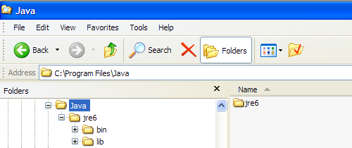

ɹəuəllıʍ ʇɐb Posted July 7, 2009 Report Share Posted July 7, 2009 I think we should try to remove that remaining JRE 1.5 item; does Secunia tell you what it found?When you open Windows Explorer, then go to C:\Program Files\Java - do you see anything else than what I have hereThis has been a nuisance for a very long time, but it is over now. From JRE 6 Update 10, there is no longer a need to uninstall the old version - it will overwrite the previous version. (But not a version from before JRE6u10.)That is why I think you should get rid of that JRE 1.5 remains - once and for all. Quote Link to comment Share on other sites More sharing options...
Lamb Chop Posted July 7, 2009 Author Report Share Posted July 7, 2009 Only have this inside my java file - no sign of JRE 1.5Cant seem to upload a print screen!But it has only JE6 in side it Bin, Read me, copyright, welcome, lib, third part license and a firefox icon which is marked welcome Quote Link to comment Share on other sites More sharing options...

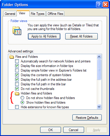

ɹəuəllıʍ ʇɐb Posted July 7, 2009 Report Share Posted July 7, 2009 But does the folder C:\i386 exist? Maybe the java.exe file is hidden?To enable (view of) hidden files in Windows Explorer, click Tools | Folder Options | tab Viewthen look again. Quote Link to comment Share on other sites More sharing options...
Lamb Chop Posted July 7, 2009 Author Report Share Posted July 7, 2009 Ok followed that alright and found the following which were not there before.1. Java 2 Platform standard edition Binary Version 5.0.60.5created 11.3.08 48kb2. J2SE Runtime environments 5.0 update 6 Type Windows installer package.Nothing else. Not a lot of J actually. Quote Link to comment Share on other sites More sharing options...
