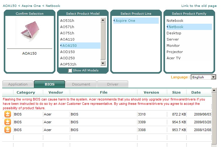

Boris Posted July 8, 2009 Report Share Posted July 8, 2009 There is now a later 3310 BIOS version (see attached)Download link :-http://global-download.acer.com/GDFiles/BI...mp;Step2=Aspire One&Step3=AOA150&OS=X01&LC=en&SC=PA_7 Quote Link to comment Share on other sites More sharing options...
kiddd_ Posted July 8, 2009 Author Report Share Posted July 8, 2009 There is now a later 3310 BIOS version (see attached)Download link :-http://global-download.acer.com/GDFiles/BI...mp;Step2=Aspire One&Step3=AOA150&OS=X01&LC=en&SC=PA_7Yes , 3310 it's the Bios version I ran in the first place(had 3305 , used 3310 to update).But this is not the problem.This issue isn't about the Bios version I used or i had , it's about the procedure I used and about the mistake and damage I've caused.Even if I try again to use a USB stick in order to 're-update' bios will not to any good.the laptop it's dead , it won't to anything at all.The power button doesn't do anything and no other LED works . Only the power LED brightens for a second when I connect AC adaptador, but that doesn't mean anything does it ? I really really need to get the system on running and solve this out..What CAN I do ? ( thank you to anyone trying helping me out ! ) Quote Link to comment Share on other sites More sharing options...
