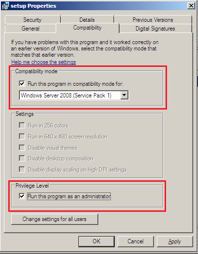

On the other hand, if you're testing Windows Server 2008 R2 and want to play with Exchange 2007 on the same box, there is a work around.
Once you have installed the standard server pre-reqs, extract the Exchange 2007 SP1 installers as you would usually, then right click the 'setup.exe' and adjust the settings to those at the bottom of this post (Windows 2008 SP1 compatibility mode, and check administrator privilege level).
After you have completed those steps, apply the changes and then right click setup.exe and 'run as administrator'.
If all goes according to plan, everything will install and you won't see "The error code was 3221684229" when installing the mailbox role.
