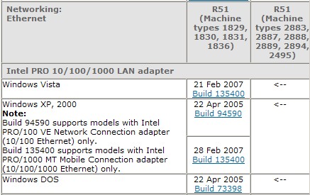

Boris Posted December 4, 2009 Report Share Posted December 4, 2009 Should be on this page :-http://www-307.ibm.com/pc/support/site.wss...html#networkingSee attachmentIt is most probably the build 94590 one ?Download it, transfer it to the laptop's desktop and run it.Reboot and hopefully it'll find your ethernet card. Quote Link to comment Share on other sites More sharing options...

liveinbox Posted December 5, 2009 Author Report Share Posted December 5, 2009 I followed the instructions for updating the drive I currently have but wasn't successful. the internet still has no connection. I even went back to the lenovo page and put in the exact model I have: ibm r51 1829-w53 and found out the ethernet you posted to download was the same as what I saw online.I tried to update because I had "1394 Net Adapter" under "Network Adapter". I updated that after I downloaded on the file link you suggested. Not sure what to do now. Quote Link to comment Share on other sites More sharing options...

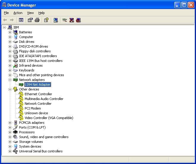

Boris Posted December 5, 2009 Report Share Posted December 5, 2009 Can you look under Device Manager and see what shows under Networks and whether there are any Unknown Device entries. Posting a screen shot of the entries would be nice. Quote Link to comment Share on other sites More sharing options...
liveinbox Posted December 5, 2009 Author Report Share Posted December 5, 2009 here it is: Quote Link to comment Share on other sites More sharing options...
Boris Posted December 5, 2009 Report Share Posted December 5, 2009 Wow - it looks like half of your laptop's devices aren't working ...... because you haven't yet installed their drivers.Did you get a driver disk with your laptop ?If not - you can get them from this page :-http://www-307.ibm.com/pc/support/site.wss/MIGR-55029.htmlAudio, modem, trackpoint, video Quote Link to comment Share on other sites More sharing options...

liveinbox Posted December 5, 2009 Author Report Share Posted December 5, 2009 with regard to ubuntu, I would have stayed with that alone were it not for it's incompatibility with Revit Architecture 2009 which I tried to download and install with something called wine.I have installed:bios updateaudio drivermodem drivervideo driverso far but the network adapter isn't installing: the website only makes reference to ethernet intell pro 100 lan adapter... which it supports but I have 1394 net adapter--won't work.I'm missing ethernet controller, network controller and unknown device under other devices. Just these three are remaining from the attached earlier.would you have any suggestions Quote Link to comment Share on other sites More sharing options...
Boris Posted December 5, 2009 Report Share Posted December 5, 2009 Your machine seems to have wireless ?If so you need to try the XP drivers under Networking:Wirelessto get that working - which is presumably the Unknown Device ?I cannot advise you which of them to choose - it is a process of trial and error Quote Link to comment Share on other sites More sharing options...
