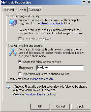

rajmahid Posted May 22, 2013 Author Report Share Posted May 22, 2013 What are the exact permissions of that folder? Can you post a screenshot of that user/pw prompt? The only permission options I can determine: right click on folder or folders, goto tab/Sharing and check "Share this folder on the network" (see attached screenshot). The folder(s) show up in my streaming Oppo BD player (with ethernet connection from router) but when I try to open them, I get that dreaded username/password box. Very frustrating...I haven't found a solution in my google searches these past few days. Once again, I can successfully stream my music to the unit by 'pushing' music content via JRiver controller software and also Foobar2000. But direct access has ben stymied. EDIT: This is probably a non-issue, stumping even the most adept M$ fans...but I found a small freeware DLNA compliant media server that does exactly what I want to do: push music/movie files to my Oppo player from my pc & external hard drives: oShare. http://sourceforge.net/projects/oshare. It's a superb solution...and I no longer have to hassle with M$ 'sharing' difficulties. Hurray!! Quote Link to comment Share on other sites More sharing options...
