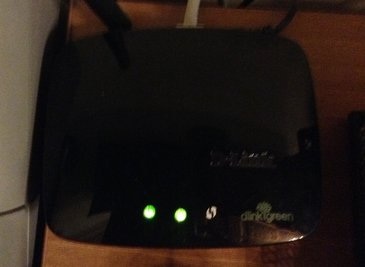

lev444 Posted May 30, 2013 Report Share Posted May 30, 2013 Hi friends,I'm using a d-link dap-1155 wifi router and have a cable internet with static ip, gateway, etc. so the problem is that i can't connect to my wifi with more than one device at the same time, as i have given the ip to the connecting devices, not to the wifi router itself, so i'm getting an ip conflict when connecting with, let's say, my iPad (when the laptop is already connected). Does anyone use this wifi device ? Please, help me to assign the ip to the router so i can connect to it from other devices with "get ip automatically" option. Thanks in advance. Quote Link to comment Share on other sites More sharing options...

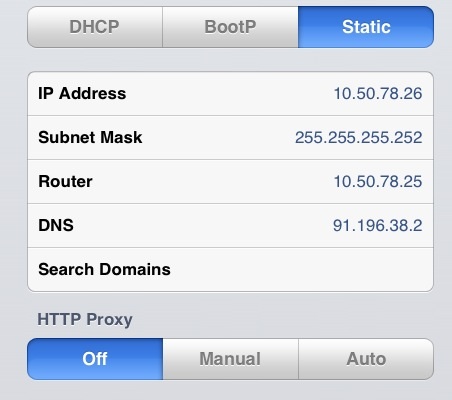

lev444 Posted June 1, 2013 Author Report Share Posted June 1, 2013 Thank you for replying. So, i have manually configured my laptop, phone and ipad to use 10.50.78.26 as my ip address. And when i try to connect via ipad when the laptop is already connected, i get an ip conflict. I guess i must assign the 10.50.78.26 to my router and use automatic configuration on laptop, ipad, phone, but don't know how to do that. Quote Link to comment Share on other sites More sharing options...

lev444 Posted June 2, 2013 Author Report Share Posted June 2, 2013 But my provider gave me just one ip to connect to internet, that is ...78.26. My devices do not connect with other ips. Is there a way to assign this ip to router, don't you know? Quote Link to comment Share on other sites More sharing options...
ɹəuəllıʍ ʇɐb Posted June 3, 2013 Report Share Posted June 3, 2013 Your IP address (on the Internet) is 91.196.38.2; that is what your provider supplies you with. Your internal network IP addresses are 10.x.x.x addresses. Actually I do not know why you are using 10.x.x.x addresses; normally home users use 192.168.x.x addresses, and these are usually automatically assigned. Quote Link to comment Share on other sites More sharing options...
