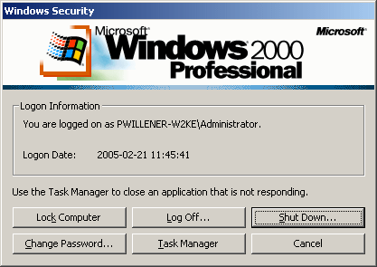

ɹəuəllıʍ ʇɐb Posted February 21, 2005 Author Report Share Posted February 21, 2005 Thanks for the replies. I think I was not very clear in my question. What I meant is this: all my Windows systems, like this W2K, open this panel on ALT-CTRL-DELI get a similar panel for all my XP systems, except one, which opens the Task Manager on ALT-CTRL-DEL. That Task Manager does have a Shutdown option, but I'd prefer to just get the same panel on all systems.There must be a way to specify that, but I seem to be unable to find our how. Quote Link to comment Share on other sites More sharing options...

ɹəuəllıʍ ʇɐb Posted February 21, 2005 Author Report Share Posted February 21, 2005 its like they said xp dont work that way. when you hit ctrl/alt/del it opens the task manager at the yop is a option to shut down if you click it. thats the way xp works.Ah no - the XP I am on right now gets me the same Options as Win2K: Lock Computer, Log Off, Shut Down, Change Password, Task Manager, and Cancel. (I can't take a screen shot of it, as this is a native Windows installation; the W2K shot was on VMWare). Quote Link to comment Share on other sites More sharing options...
-pops- Posted February 21, 2005 Report Share Posted February 21, 2005 Thanks for the replies. I think I was not very clear in my question. What I meant is this: all my Windows systems, like this W2K, open this panel on ALT-CTRL-DELI get a similar panel for all my XP systems, except one, which opens the Task Manager on ALT-CTRL-DEL. That Task Manager does have a Shutdown option, but I'd prefer to just get the same panel on all systems.There must be a way to specify that, but I seem to be unable to find our how.I have built upwards of 100 XP systems and never seen a screen such as the one you show by pressing CTRL-ALT-DEL.Do the machines where this screen appears have additions that may cause this? Quote Link to comment Share on other sites More sharing options...

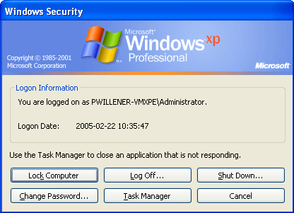

ɹəuəllıʍ ʇɐb Posted February 22, 2005 Author Report Share Posted February 22, 2005 My assumption yesterday was that (domain) network computers behave "normally", i.e. CTRL-ALT-DEL will pop-up the shutdown menu, and non-networked computers will open the Task Manager.Very strange, indeed, and hardly believable. So I decided to test it. I installed a brand-new XP Professional system on WMWare. Although it is connected to the network, I only login as the local Administrator. I change nothing, except the keyboard layout and date & time format. Then I click CTRL-ALT-DEL:This is for me the "normal" behaviour of Windows since NT4. So why do some systems open the Task Manager on CTRL-ALT-DEL, and others open the 'Windows Security' panel with the Shut Down option?It's a mystery to me... Quote Link to comment Share on other sites More sharing options...
ɹəuəllıʍ ʇɐb Posted February 22, 2005 Author Report Share Posted February 22, 2005 Although it is connected to the network, I only login as the local Administrator.Thinking some more about this...Although I only login as a local user, during the installation the computer was joined to a domain. Maybe that makes a difference?Any network expert ever noticed if that makes a difference? Quote Link to comment Share on other sites More sharing options...
Scarecrow Man Posted March 9, 2005 Report Share Posted March 9, 2005 That is very likely. Being on a Domain changes a lot of things.Sorry for the late reply. Quote Link to comment Share on other sites More sharing options...
