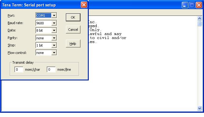

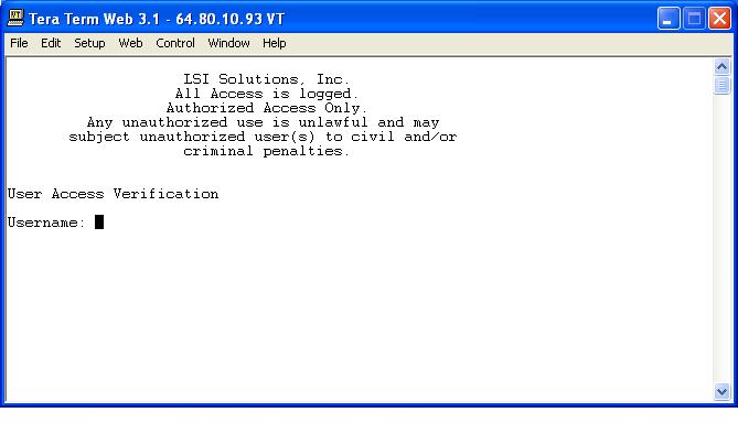

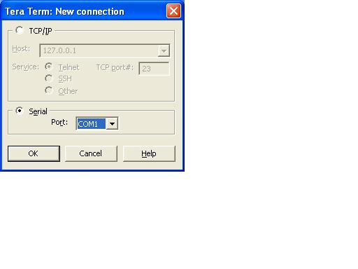

homecomputeraid Posted April 23, 2005 Report Share Posted April 23, 2005 I'm not sure how much this will interest the general forum population, but some of the moderators and people who work on PC's and Routers may like it.If you have to do a terminal session to a router or a CSU/DSU, or any network device, you might try TeraTerm. It has a simple, clean interface that at makes it easy to configure and use, it works with a lot of network devices (not finicky like Windows HyperTerm), and best of all, it's FREE!You can download the latest version (as of this writing, 3.1.3) at this link:http://www.ayera.com/teraterm/download.htmAfter downloading, just unzip it, and double click the executable! No installation, per se. It does TCP/IP connections (Telnet, SSH (secure), or a port you specify), or serial connections. When using serial connections, use make sure you set the speed, parity, etc. to work with the device you're connecting to. 9600 baud, 8 Data Bits, no Parity, 1 Stop Bit, and no Flow Control works with many devices.[edit]Here are a few screen shots:Initial connection type screen:Session running shot:Serial Port configuration (go to Setup, Serial Port):I strongly recommend using SSH for devices that support it. Cisco routers will support SSH if you have a code version that allows you to set the required type of encryption. PIX firewalls support SSH.Telnet sends traffic clear text meaning it could be intercepted as it goes across the network or the Internet. SSH is encrypted.I'll post some screen shots tomorrow.Enjoy! Quote Link to comment Share on other sites More sharing options...

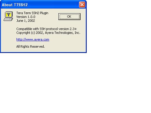

Redhat Posted April 25, 2005 Report Share Posted April 25, 2005 Is it SSH1 or 2? Can't find any info on the site :( Quote Link to comment Share on other sites More sharing options...
homecomputeraid Posted April 25, 2005 Author Report Share Posted April 25, 2005 It looks from Help, About SSH2 Plugin like it's SSH2: Quote Link to comment Share on other sites More sharing options...
Redhat Posted April 25, 2005 Report Share Posted April 25, 2005 Thanks HCA, shall get it now and see how it shapes up against Putty :D Quote Link to comment Share on other sites More sharing options...
