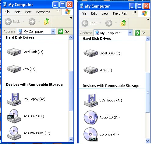

They say a picture's worth a thousand words so here'e what my comp looks like before /after putting different media into the drives:
post-4959-1153657430_thumb.jpg Click to enlarge the pic and you'll see my F drive at the bottom has apparently changed itself from a DVD-RW to a CD drive (with a CD-R in it). I wonder if this is the sort of thing you're seeing? If so, just open up another window with your photos and drag/drop a pic onto the drive-windows should get all helpful and offer to write to CD. If not then you'll have to use Nero.

Thanks so much xp. That's exactly what it was doing except any time I tried to double click on the drive after putting the cd in, it gave me a "drive not accessible" message. I ultimately had to install Nero and it worked. I'm thinking I forgot to intall that driver when I reloaded my computer so I'm pretty much just a huge DORK. :rolleyes: I have now burned my photo's to a cd and feel a bit more secure knowing I can now. I've tried a memory stick with no luck. I shoot in large format JPEG for a lot of my personal stuff but when I'm shooting something important to me or shooting for other people, I shoot in RAW format to save the image integrity and those files range from 2-6 MB's per file. When you have 60 photo's to work on, a memory stick is useless. I can't wait to get my external drive because the cd method, though okay for making print cd's for clients, is not good for backing up the original processed files. Also, although JPEGs back up fine on usually one cd, I use 2-3 cd's just for the RAW & TIFF files.
