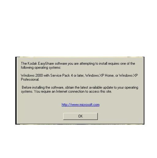

Hi again. Yes USA Texas...Here is a picture I learn this today from andsome. It says for Window's 2000, nothing about
Windows ME. I don't know if Service Pack 4 will work for ME, do you know? and if so where can I download it.
Everyone has been so helpful.........MUCH APPRECITATED.
Service pack 4 is not for ME, It will not install.
