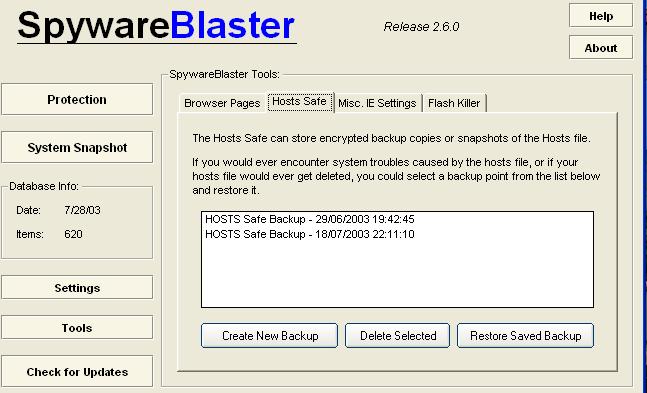

mark2 Posted July 31, 2003 Report Share Posted July 31, 2003 If it was just script kiddies, perhaps they know no more than this equivalent of 'I wuz ere' but i would be changing passwords etc and notifying anybody that matters in case of further developments. ie banking / accounting details. Quote Link to comment Share on other sites More sharing options...

mark2 Posted August 1, 2003 Report Share Posted August 1, 2003 wlfdgcrkzI know very little about servers etc (or anything else :blink: )but as bvw has said spywareblaster allows you to lock the hosts file.Script sentry will prevent unauthorised scripts running.I think I'd be inclined to install these on the windows box as an added layer of security. Quote Link to comment Share on other sites More sharing options...
