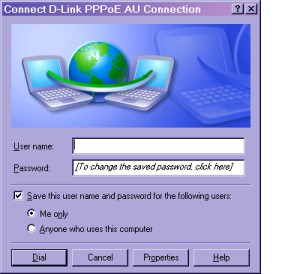

Lamb Chop Posted July 15, 2008 Author Report Share Posted July 15, 2008 Irene - thanks for that but I want to find the missing piece I lost in the snafu over ZA and K951748.Pat - this is the window from start>connect>In screen shot.The one that appeared on boot up is different - smaller - same one as old dial up via telephone line but I still have dial up broadband so need it to auto connect or I have to wait for it to boot and load and then start.connect etc whereas used to walk away and do other jobs whilst it got on with connecting and updating and collecting emails and all the anti virus and spyware auto updates.That is the missing one - maybe if you don't have dial up broadband it doesn't appear. Who knows I don't as only ever had old dial up and then dial up broadband - it dials my ISP I imagine. so this is all I have left to date - I have uninstalled the patch and completely uninstalled ZA and then reinstalled ZA with no memory so going thru learning curve and then downloaded the patch. Didnt help. I had also tried system restore and no changes on several times and just before the loss of connection caused by patch. Quote Link to comment Share on other sites More sharing options...

Lamb Chop Posted July 15, 2008 Author Report Share Posted July 15, 2008 I wonder if D-link Support can help?I will give them a go Irene and have done a shortcut too for now :D PS did you see I did a screenshot upload and with your tutoring too and resized it. Wow I'm learning :lol: Quote Link to comment Share on other sites More sharing options...
ɹəuəllıʍ ʇɐb Posted July 15, 2008 Report Share Posted July 15, 2008 PS did you see I did a screenshot upload and with your tutoring too and resized it...I have seen it, but it's so tiny that I can't recognize anything on it. You must have very good eyes... Quote Link to comment Share on other sites More sharing options...
Lamb Chop Posted July 15, 2008 Author Report Share Posted July 15, 2008 OOps I resized to 50% - maybe to small but thought anyone would recognise it if on their XP home and on dial up broadband of course :D Here is 75% Quote Link to comment Share on other sites More sharing options...
