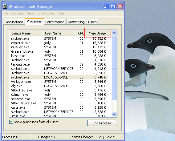

bludgard Posted January 14, 2011 Report Share Posted January 14, 2011 Do you have any idea of what my problem(s) are?Hello,mlibkind.Have you tried disconnecting the new Seagate Drive to compare performance?There may be a memory issue as if you have backups running in the background as well.No way to add a little more?Navigate to Processes>Memory within Task Manager.Click on the Mem Usage tab until the highest values are shown at the top.(See pic below)If you could post a screen shot of Task Manager it may offer some clues in a non-invasive way.If it turns out to be more complex than that,well....I would suggest holding off on installing anything else until you have done the basics to try to resolve this issue.One Quote Link to comment Share on other sites More sharing options...
