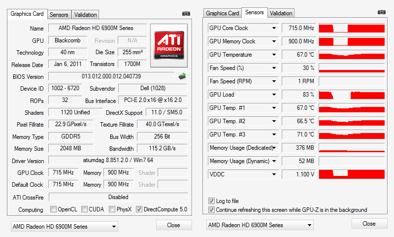

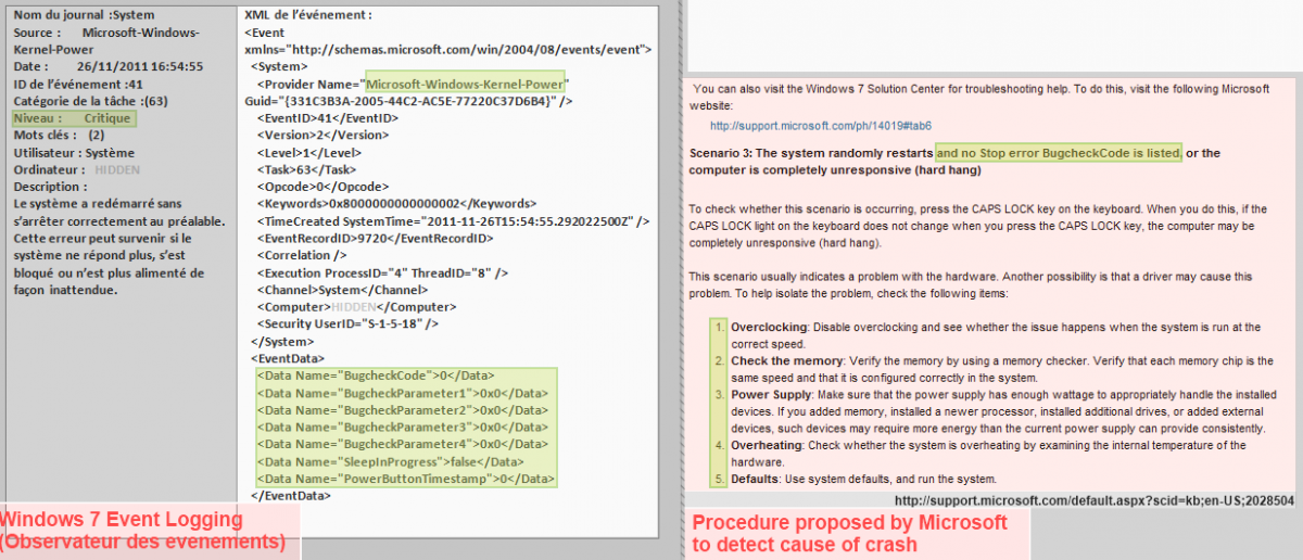

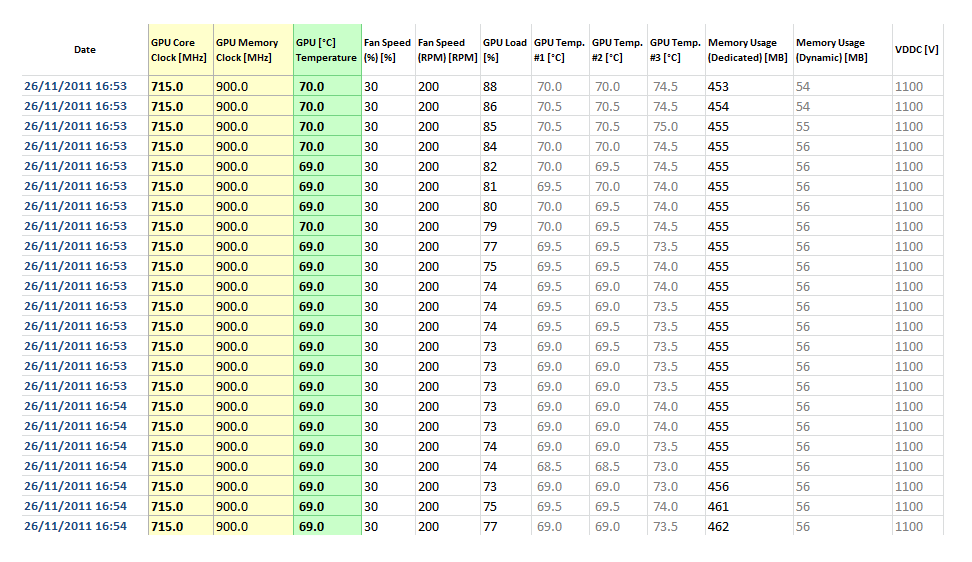

hasaf Posted November 26, 2011 Report Share Posted November 26, 2011 Hello everyone, Here's the deal : I was playing Crysis 2 on my new Alienware M17x R3 with famous AMD 6900M (as GPU-Z shows) and suddenly it crashed after 10 minutes of gameplay. I first checked all "basic" stuff like Services running, error notifications, heating .. everything seemed normal. I went to Windows event viewer and found out Kernel-Power error with Code 0. check http://support.micro...b;en-US;2028504 for more information about this error type. At the bottom of the page, you'll see what I illustrated in attached images - 5 possible causes. Please check the images for all details. This is really annoying when you think you can finally play and windows shuts down with no warning! but for a CRITICAL error :S Help! Thanks in advance!! Link to comment Share on other sites More sharing options...
