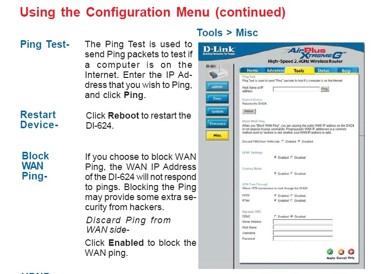

benb Posted March 27, 2005 Author Report Share Posted March 27, 2005 I partially answered my own question, I found the place to change Zonealarm Options (see attachment for instructions) but I was not able to pass Shields UP. Do you think it is getting into another computer on my home network? There are two wired desktops, and one wireless laptop. One desktop (this) is running a fully updated SP2 w/ Zonealarm Pro. Desktop 2 is running SP1 and as we speak is installing SP2 and is running Zonealarm Pro. The laptop is running SP2 and I do not believe it is running a firewall (it is in use right now, so I can't check). Since they are behind a router, not a hub, they all share the same IP. Any suggestions now? Quote Link to comment Share on other sites More sharing options...

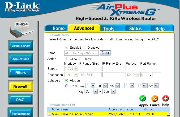

benb Posted March 28, 2005 Author Report Share Posted March 28, 2005 Okay, I found exactly what you were talking about, but I am not able to edit it. I am logged into my router as "admin" so I don't know what's going on. Screenshot attached. Quote Link to comment Share on other sites More sharing options...
mark2 Posted March 28, 2005 Report Share Posted March 28, 2005 It appears you need to be in Tools > misc to be able to block the wan ping Quote Link to comment Share on other sites More sharing options...
benb Posted March 28, 2005 Author Report Share Posted March 28, 2005 THANK YOU!!!!!!!!! It's just so beautiful.... :P Quote Link to comment Share on other sites More sharing options...
