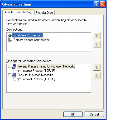

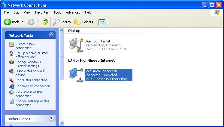

homecomputeraid Posted January 1, 2006 Report Share Posted January 1, 2006 I hate those 'wizards'! I'll get you going soon. I have to find where the 'wizard' screwed it up. I think I have to walk you through changing the priority connection in your TCP/IP Advanced Settings. I'll give you a step-by-step as soon as I get it figured out. If I remember right, I helped SpikeyChris with that not too long ago. [edit]Bus situation? Quote Link to comment Share on other sites More sharing options...
homecomputeraid Posted January 1, 2006 Report Share Posted January 1, 2006 First, I don't think you needed to run the Wizard, as your computer already was set to use the Ethernet NIC and obtain a DHCP Address from your Cable Modem. The only thing you would have had to do is reboot your PC to obtain an IP Address from your new Wireless Router instead of the Cable Modem. When you ran the Wizard, Windows may have become 'confused' and thought you were changing your method of getting to the Internet. I hope that makes sense for you.To correct the Wizard's error, go to Start, Control Panel, Network and Internet Connections, then click on Network Connections. The Network Connections window will open:Highlight your Local Area Connection by clicking on it, then click Advanced on the menu at the top of the window and select Advanced Settings by clicking on it.Make sure your Local Area Connection is listed in the top of the Connections. If it isn't, select it, and hit the Up Arrow to the right to move it up until it appears on top.Please let us know if that works. Quote Link to comment Share on other sites More sharing options...
scottygio Posted January 2, 2006 Author Report Share Posted January 2, 2006 thanks for the help. I did as you asked, my local area connection was indeed second so i moved it up a notch. However i'm still getting the same error message when i VIEW WORKGROUP COMPUTERSMYFAMILY is not accessible. you might not have permission to use the network resource. Contact the adminsitrator of this server to find out if you have access permissions.The list of servers for this workgroup is not currently available.I restarted my computer and checked the advanced settings again and the local area connection is indeed at the top notch so all is well in that respect. I actually bought a network book to help but obviously something is wrong with getting permission. I hope you might have some other thing i could try,regardsscottthanks again Quote Link to comment Share on other sites More sharing options...

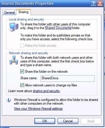

mark2 Posted January 2, 2006 Report Share Posted January 2, 2006 Have you disabled the any firewalls (temporarily) ?Have you enabled Network sharing on the Pcs ?Do you have a shared folder on each pc ? Quote Link to comment Share on other sites More sharing options...
scottygio Posted January 2, 2006 Author Report Share Posted January 2, 2006 i think the problem might be the laptop side.on the laptop i created a new network and renamed the laptop laptop1. when i go to network places on the main computer i can VIEW WORKGROUP COMPUTERS, all the icons are there i.e. main computer, laptop and now laptop1.but the laptop, when i VIEW WORKGROUP COMPUTERS i get an error message - myfamily is not accessible. blah blah blah network path was not found.How can i delete workgroups? I think i might be better deleting all networks and try creating a new network again.hope you can helpthanksscottyes i have shared folders on both pchow do you enable network sharing on te pcsno i did not disable any firewalls Quote Link to comment Share on other sites More sharing options...
mark2 Posted January 2, 2006 Report Share Posted January 2, 2006 how do you enable network sharing on te pcsR/click the shared folder>sharing and security>sharing >tick "share this folder on the network" and "allow network users to change my files" second option is if you want to work on files on the laptop from your desktopno i did not disable any firewallsWhich firewall are you using ? Quote Link to comment Share on other sites More sharing options...
scottygio Posted January 3, 2006 Author Report Share Posted January 3, 2006 no firewall is being used on the laptop, zonealarm is being used on the main computer.thanksscott Quote Link to comment Share on other sites More sharing options...
