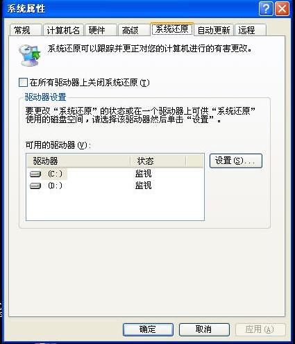

Seshomaru Samma Posted May 23, 2006 Author Report Share Posted May 23, 2006 I use Norton Ghost 2003 with no problems, but it does not do incremental backups. The Image backups are fine.What does incremental backup mean?Dorian said :Resetting system restore points....1) On the Desktop, right-click My Computer2) Click on Properties. Click the System Restore tab.3) Look for the box near the top which says "Turn off system restore off on all drives"4) Place a tick in the box to disable5) Click Apply first, and then click OK and the window will dissapear.Now reboot your computer....6) Right-click My Computer once more7) Click on Properties. Click the System Restore tab again8) Look for the box near the top which says "Turn off system restore off on all drives"9)Take out the tick from the box so it is empty10) Click Apply first, and then click OK.I believe I followed your instructions correctlythe end result should look like this :right? Quote Link to comment Share on other sites More sharing options...
Dorian Posted May 23, 2006 Report Share Posted May 23, 2006 eeeek im no expert in other languages! But I can see that the box is unchecked which is correct, both drives should be set at the status of "Monitoring" Quote Link to comment Share on other sites More sharing options...
