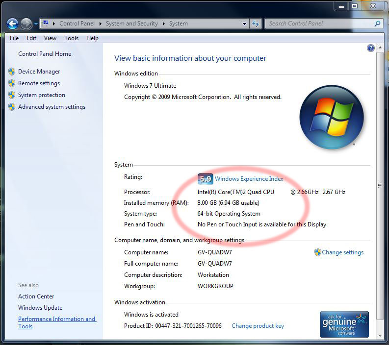

George Voudouris Posted May 30, 2009 Report Share Posted May 30, 2009 8GB of ram installed in windows 7 64bit, but only 6.94 usable! Why is this?Ram brand: Kingston at 800MHZ, Motherboard: Asus P5B, Graphics Card IS NOT onboard.Any Ideas?Thank youGeorge Quote Link to comment Share on other sites More sharing options...

Boris Posted May 30, 2009 Report Share Posted May 30, 2009 8GB of ram installed in windows 7 64bit, but only 6.94 usable! Why is this?Ram brand: Kingston at 800MHZ, Motherboard: Asus P5B, Graphics Card IS NOT onboard.Any Ideas?Thank youGeorgeGeorgeCan you post a screenshot showing the results of whatever tool you are using to show that only 6.94GB is usable Quote Link to comment Share on other sites More sharing options...

George Voudouris Posted May 30, 2009 Author Report Share Posted May 30, 2009 Its the standard windows report.... Quote Link to comment Share on other sites More sharing options...
George Voudouris Posted May 30, 2009 Author Report Share Posted May 30, 2009 Its the standard windows report....I post another screenshot, that can be read better Quote Link to comment Share on other sites More sharing options...
Boris Posted May 30, 2009 Report Share Posted May 30, 2009 There is usually a BIOS setting called "mapping PCI space above the memory limit" or something like that. You need to to turn this on.Also check that BIOS or other settings in BIOS are not being cached to RAM - that can also cause an issue. Quote Link to comment Share on other sites More sharing options...

George Voudouris Posted May 31, 2009 Author Report Share Posted May 31, 2009 8GB of ram installed in windows 7 64bit, but only 6.94 usable! Why is this?Ram brand: Kingston at 800MHZ, Motherboard: Asus P5B, Graphics Card IS NOT onboard.Any Ideas?Thank youGeorgeCheck your bios settings if by accident there is not an onboard video card enabled.Also check the memory and cache related BIOS settings.Is the POST memory self test finding the total 8GB??The only thing I fount in BIOS is a System Report stating that there are 7.104 MB available memory....How do I do the `memory self test`? Quote Link to comment Share on other sites More sharing options...

Boris Posted May 31, 2009 Report Share Posted May 31, 2009 The only thing I fount in BIOS is a System Report stating that there are 7.104 MB available memory....How do I do the `memory self test`?There should be a setting in the BIOS - if nothing obvious, you may have to unselect "fast boot" or a similar description Quote Link to comment Share on other sites More sharing options...
