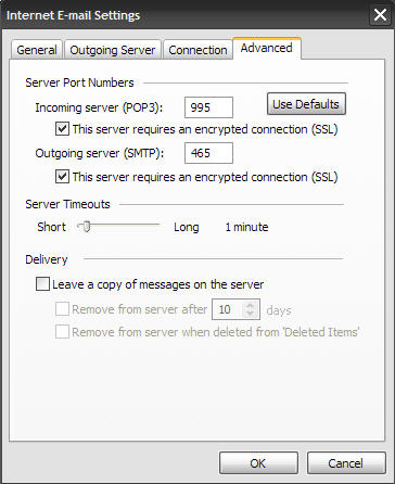

nellie2 Posted February 3, 2007 Report Share Posted February 3, 2007 You have done this bit?# Click the "More Settings" box and select the "Outgoing Server" tab.# Check the box next to "My outgoing server (SMTP) requires authentication."# Click the "Advanced" tab.# Under "Incoming Server (POP3)", check the box next to "This server requires an encrypted connection (SSL)". The port number in the "Incoming Server (POP3)" field should automatically change from 110 to 995. If it doesn't, make sure the port number is set to 995.# Under "Outgoing Server (SMTP)", check the box next to "This server requires an encrypted connection (SSL). Enter port number "465" in the "Outgoing Server (SMTP)" field.# If you would like to keep a copy of your email messages on the Yahoo! Mail server, select the "Advanced" tab. Check the box next to "Leave a copy of messages on the server."# Click the "OK" button.# Click the "Next" button on the Email Account Wizard, then click "Finished." Quote Link to comment Share on other sites More sharing options...

nellie2 Posted February 3, 2007 Report Share Posted February 3, 2007 Your's looks like my screen shot? Have you actually tried sending an email, the account that I have like that one fails the Outlook test too... but I can send ok when I actually send... if you know what I mean Quote Link to comment Share on other sites More sharing options...
Irene Posted February 3, 2007 Report Share Posted February 3, 2007 Your's looks like my screen shot? Have you actually tried sending an email, the account that I have like that one fails the Outlook test too... but I can send ok when I actually send... if you know what I meanHi NellieThis is how mine looks... Quote Link to comment Share on other sites More sharing options...
Kirbster Posted February 3, 2007 Author Report Share Posted February 3, 2007 yes, identical.Get the usual error messages when trying to send/receive mail not just testing settings! Quote Link to comment Share on other sites More sharing options...
nellie2 Posted February 3, 2007 Report Share Posted February 3, 2007 Hi Irene... Kirbster needs to make sure his settings are the same as in my screenshot, different email accounts require different settings.. very confusing!! Quote Link to comment Share on other sites More sharing options...
