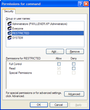

ɹəuəllıʍ ʇɐb Posted March 28, 2008 Report Share Posted March 28, 2008 Thanks, Irene, for holding Jacob's hand while I was sleeping :)So, let's try to do this. What I would try first, if I were in your situation, is to 'Run As' Administrator, without a password. About 90% of all computers I know have the default Administrator account with a null password.If that does not work out, we will have to go into the registry. Before we do that, go back to Irene's post where she points to ERUNT - download it, install it, then make a registry backup.Next, open the Registry Editor (Start -> Run -> type regedit [OK]).Do a search (F3) for key .wzmul - you should find it at HKEY_CLASSES_ROOT\.wzmulNow click on the boxed + on the left, to expand the subkeys. Do it also for subkeys shell and open - you will last see subkey command. Right-click on it and select Permissions. Check the permissions for your user or user type (RESTRICTED). If it does not have Full Control, check the box for Full Control, then click OK.Now try the installation again, and let us know how it goes. Quote Link to comment Share on other sites More sharing options...

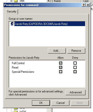

Jacob Posted March 28, 2008 Author Report Share Posted March 28, 2008 Check the permissions for your user or user type (RESTRICTED). If it does not have Full Control, check the box for Full Control, then click OK.Got stuck here.I don't see any permissions (RESTRICTED)The box for Full Control is already checked.Special Permissions is not checked.Do I need to add User name Administrator? Quote Link to comment Share on other sites More sharing options...
ɹəuəllıʍ ʇɐb Posted March 28, 2008 Report Share Posted March 28, 2008 Not sure what you see; my Permissions panel looks like thisWhat does it look like if you select your own userid? Can you post a screenshot? Quote Link to comment Share on other sites More sharing options...
Jacob Posted March 28, 2008 Author Report Share Posted March 28, 2008 Here is my screen shot Quote Link to comment Share on other sites More sharing options...
ɹəuəllıʍ ʇɐb Posted March 28, 2008 Report Share Posted March 28, 2008 Hmm... this looks OK. However, I just remember what you wrote earlierUKNOWN\.wzmul\shell\open\command. Varify that you have sufficient access to that key.That 'UNKNOWN' thing may be the cause of the problem. However, I have no idea where this is coming from, or how to fix it.Have you tried to run the installer 'Run As' Administrator without a password? Quote Link to comment Share on other sites More sharing options...
