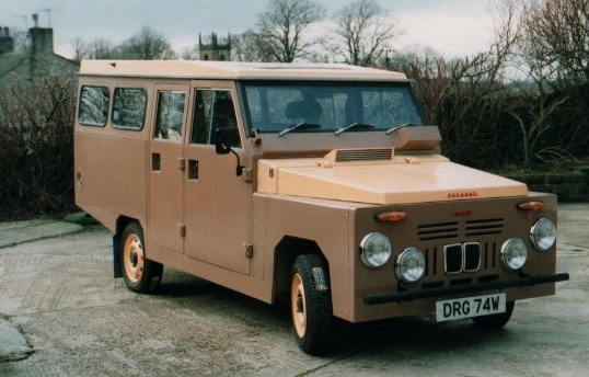

catgate Posted November 19, 2017 Report Share Posted November 19, 2017 This is one I made earlier, It's original purpose was to be a general run about with the ability to have enough space in it to have a nap, when we came off the midnight boat in I.O.M. I built it in the garage/workshop at Catgate. The chassis was made out of some new left over surplus pallet racking All the body is fibreglass with the exception of the floor and that is stainless steel. All the fasteners are "Allen bolts" into "pop-rivet" type nuts. The biggest time gobbler was the making of the moulds. Every panel was different and had to be a perfect fit to the next door panel. It looks like a cast off failed Landrover , but it was more or less inevitable due to the difficulty of having to make a mould for every panel, and the making of curved panels is no fun. Quote Link to comment Share on other sites More sharing options...

catgate Posted November 19, 2017 Author Report Share Posted November 19, 2017 Is that not bizarre. That is the thing without a doubt. A week or so after the man bought it he rang me and asked if I knew how to fasten "That imitation grass, like greengrocers and fish sellers use in their shop windows." over the bonnet. After another week or so had gone by he arrived at our front door. My wife went to deal with him, and came back with a neat plastic bag containing a T-shirt with "Ugly Truck" printed on the front. He and his mate/chum/partner were going to tour France selling "Ugly Truck" T shirts !!!! He had brought one for me. I still have it, unopened.. As far as the ugly truck itself is concerned I have only had one expedition to try to find it. That was a bit of a blow because one chap that I spoke to, who was from "the area where it lived," said he had seen it on the back of a wagon, which he thought was a scrap truck. I would dearly like to know just where it went. It had on it a silencing system that was so effective that if you stood at the back of the animal on fast tick over it was silent. Quote Link to comment Share on other sites More sharing options...

catgate Posted November 20, 2017 Author Report Share Posted November 20, 2017 It might be nice to hear his saga, but, knowing what I do about him, it will be more fiction than fact,...and there has already been more than enough in this shambles. I feel rather cross in some way that I spent a lot of time and effort making the thing and it has just been ruined. Where ever possible, fastenings were captive nuts and socket head bolts, to facilitate easy dismantling, when needed, using just a set of alan keys. All the fastenings were socket head and, in many places, stainless steel. I had conceived a "different" exhaust system using a couple of cast aluminium silencer which could be taken apart for internal cleaning when needed. and if one was standing at the back of the vehicle the only thing that gave any indication the engine was running was the slight movement of the vehicle. Quote Link to comment Share on other sites More sharing options...
