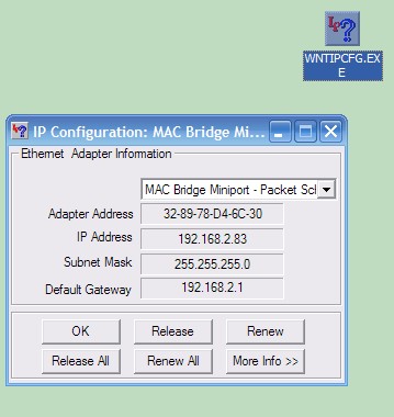

mark2 Posted January 23, 2005 Report Share Posted January 23, 2005 I've found the WNTIPCFG from W2000 works with XP, giving IP addy and gatewayssee here I have the .exe sitting on my desktop, haven't installed it, works with a simple double click Quote Link to comment Share on other sites More sharing options...
Agent Smith Posted January 23, 2005 Report Share Posted January 23, 2005 Good call from mark2, I use it a lot.You can download it direct from M$ Click HereThe installer is a simple self extractor. Once extracted, simply put a copy of the wntipcfg.exe in your system32 directory. If like me you are a bit nostalgic, you can even rename it winipcfg.exe and use it just like the old Win9x version.Mr. IM Quote Link to comment Share on other sites More sharing options...
