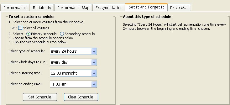

Ok, I have now purchased and installed the Professional version. I have not tested "Set It and Forget It"; I have just run manual defrags and boot-time defrags.
Now I want to set a schedule to defrag some of my partitions every night, but I can't figure out how. The available options are
  • Set Smart Schedule - this option will enable defragmentation of the selected volume(s) any time defragmentation is needed, day or night.
  • Set Smart Schedule after hours - this option will enable Smart Scheduling "after hours". This will cause Diskeeper to run when defragmentation is needed, but only between the hours of 10pm and 4am.
  • Set to run every night - this option will enable scheduling to run every night. Diskeeper will run every 2 hours each night, between 10pm and 4am.
  • Set to run on weekends only - this option will enable scheduling to run on weekends only. Diskeeper will run every 4 hours on Saturday and Sunday.
  • Set Screen Saver Mode - this option will enable Screen Saver mode. Diskeeper will run any time the screen saver is active. When the screen saver stops, defragmentation will stop running.
  • Set a custom schedule - this allows me to set a one-time schedule, continuous run, every 2, 4, 8, 12, 24, 48, or 72 hours, or "Smart Scheduling". Additionally I can select every day, or exception days.
This is perfectly not what I want! I want it to run once every night, at random times between 22:00 and 04:00. Is that possible? How?
