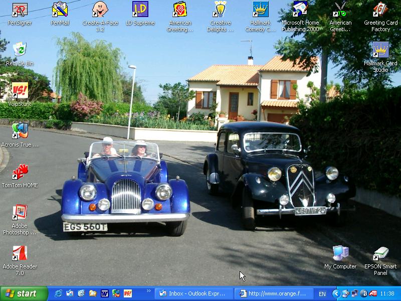

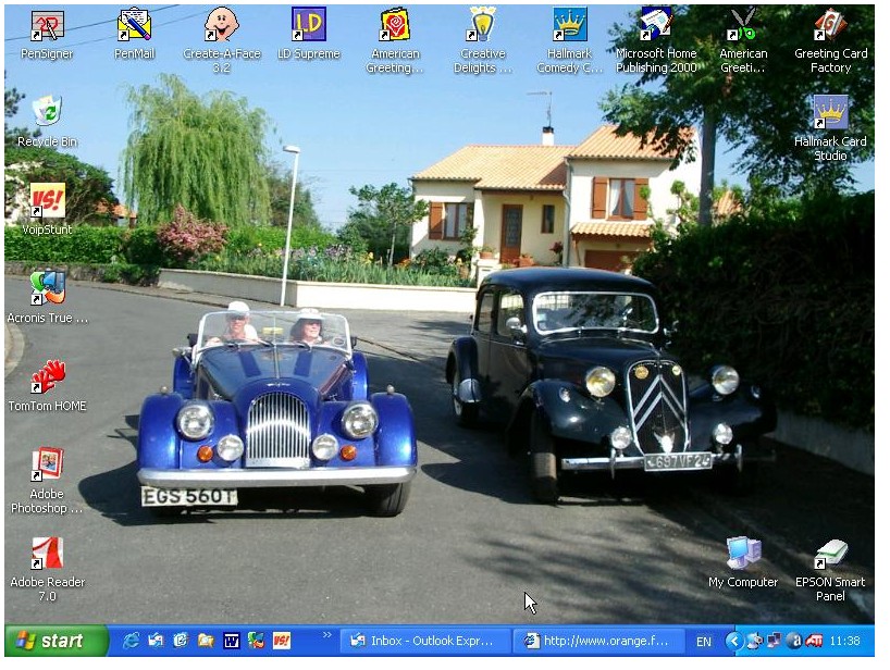

Well, all is not as it should be, yesterday the monitor was working fine, today, as I hope the attached screen shot will show, the colour is all to pot. It shows Green down the left hand side and purple down the right. I have not altered any settings since I got the replacement so any ideas what might be causing the colour imbalance?
No still the same,F11 opened a new tab, switched between them and couldn't see any difference.
A screen capture of what I see, as its smaller it should be in the middle fo your screen I hope
When I click on it , it does open in the middle of the screen but then when I click on it with F11 it goes full screen and I can see the problem colours.
I just copped it into a photo editor and still cant see the problem. Not being an expert on this, but as your screen shot is allright away from your monitor I would think you have another bad monitor. The only other thing is are there any magnets (speakers) at the sides of your monitor that could be affecting it. I know this used to be a problem.
I do have speakers at the side of the monitor but they have always been there, I'll try moving them .
Just to make it very clear, when I click on the desktop image it opens in a new window, if I then click on F11 in that window I can see the problem with the colours.
