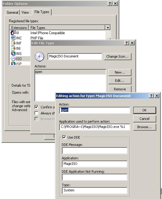

cozofdeath Posted April 22, 2007 Report Share Posted April 22, 2007 Yeah I would delete them but thats just me. Non are serious to the point of your computer not starting back up. But I would still make a registry backup before changing anything. If the values aren't there, deleting shouldn't cause a problem. For others viewing this with context problems another good thing for fixing context problems is the File Types tab in the Folder Options. Most don't realize this can be used to fix not only any file extension context menu item but general folder and file as well. I posted a screenshot below. However it can not be used to fix others like * context items that affect all the files and folders or GUID/COM objects. For that a special program must be used or you have to have knowledge of the object. Libraries (.dlls) and other files that have the guid/com objects are not always programmed correctly and can cause weird things as well. I think that is what happened with that MagicISO thing as well. I searched and searched and everything looked fine. I think I'm going to email them and see if its on their end. Quote Link to comment Share on other sites More sharing options...
