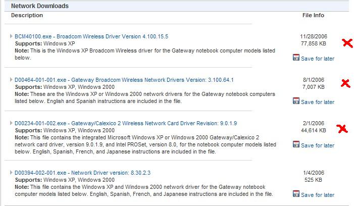

Your problems with installing that driver is because that is the driver for your ethernet port :)
Your wireless card driver will be one of these marked X below
http://support.gateway.com/support/drivers...10406&type=
I would try the top Broadcom one ?
