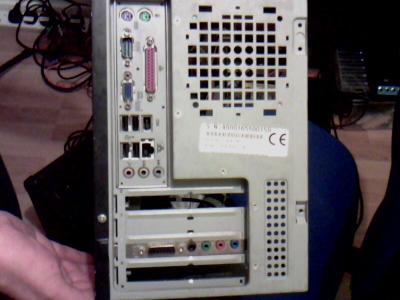

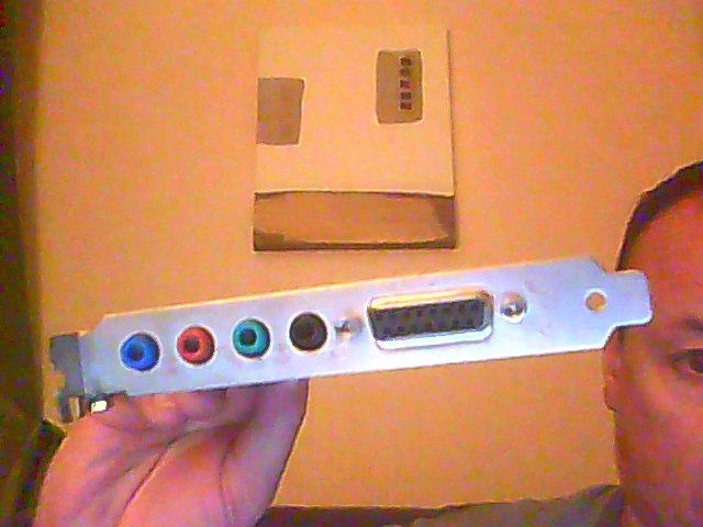

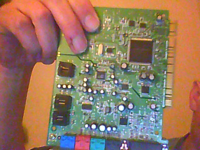

george riley Posted January 23, 2012 Author Report Share Posted January 23, 2012 ive taken a couple of piccies it might help Quote Link to comment Share on other sites More sharing options...
Boris Posted January 23, 2012 Report Share Posted January 23, 2012 George, I presume that you normally plug your monitor into the blue connector at the top ? The bad news is - your card (as held up) is a Sound card - not a graphics card. The black connector is not for a monitor :( Quote Link to comment Share on other sites More sharing options...

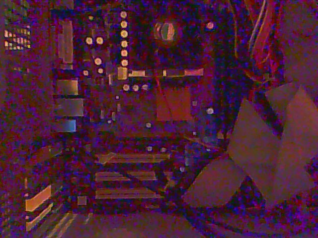

Boris Posted January 23, 2012 Report Share Posted January 23, 2012 Can you post a picture of your motherboard, showing its expansion slots so that I can tell you whether you can fit a graphics card, rather than use on-board graphics. Quote Link to comment Share on other sites More sharing options...
george riley Posted January 23, 2012 Author Report Share Posted January 23, 2012 best i can do im afraid Quote Link to comment Share on other sites More sharing options...
rong Posted January 23, 2012 Report Share Posted January 23, 2012 It's this one Boris SIS-651(SOCKET478) http://www.geeks.com/details.asp?invtid=P4S533-MX-BO-R&cat=MBB Quote Link to comment Share on other sites More sharing options...

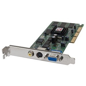

Boris Posted January 23, 2012 Report Share Posted January 23, 2012 Thanks rong :) That will take an AGP 4x graphics card - IF George can source one (relatively obsolete now !) EDIT Found this on Amazon :-http://www.amazon.co.uk/ATI-Radeon-256MB-Videocard-TV-out/dp/B002Z3J6RS/ref=sr_1_2?s=computers&ie=UTF8&qid=1327356310&sr=1-2 Quote Link to comment Share on other sites More sharing options...
george riley Posted January 24, 2012 Author Report Share Posted January 24, 2012 hi guys many thanks for all your help top forum this one Quote Link to comment Share on other sites More sharing options...
george riley Posted January 24, 2012 Author Report Share Posted January 24, 2012 will this one do guys? Quote Link to comment Share on other sites More sharing options...
