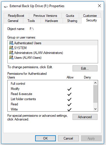

AlanHo Posted April 24, 2018 Report Share Posted April 24, 2018 This is a long shot - but perhaps the security settings for the external drive have been changed somehow. Are your settings like this with modify and write ticked ? :- Quote Link to comment Share on other sites More sharing options...

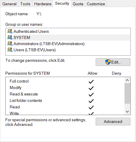

cemster Posted April 24, 2018 Author Report Share Posted April 24, 2018 So I made System the owner and these are all checked. Nothing has changed... And they were all checked for each user since the beginning... Quote Link to comment Share on other sites More sharing options...
