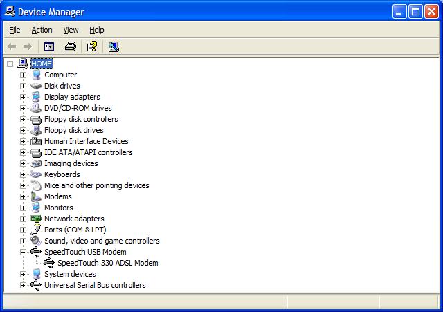

djohn Posted December 14, 2004 Report Share Posted December 14, 2004 This is how it shows in my device manager. I'm on XP Pro but I think it should be the same for you? Quote Link to comment Share on other sites More sharing options...
don't ask Posted December 14, 2004 Author Report Share Posted December 14, 2004 "This is how it shows in my device manager. I'm on XP Pro but I think it should be the same for you? "Yes Djohn - when I manage to get up and running that is what sometimes shows - this morning it showed as an Unknown Device with a yellow question mark as an item on the main list - other times it is listed under USB Controllers as an Unknown Device.-pops- every day (sometimes twice or more) I am using the Uninstall provided on the disk provided - restarting machine - removing everything except systray and explorer from Ctrl/Alt/Del box and loading afresh from the disk. It works when installed from new, but when I power down and start machine up later in the day the computer tells me there is no device (the icons are in the system tray 'tho).The only thing in common with the new installations is that when I do get it running the message that shows when I hover on its icon is 'PPP disconnected'.Got to pop out and post a snail mail letter. Quote Link to comment Share on other sites More sharing options...

djohn Posted December 14, 2004 Report Share Posted December 14, 2004 When you first install the modem and have it working. bring up device manager as in my screen shot above. Scroll down to USB modem and click on the plus sign to expand, it should now show the actual modem, again as in my screenshot.Right click on the modem, choose properties from there and see if a power management tab appears, if so remove the tick from "Allow the computer........" I know you have already tried this but may have been looking in the wrong place or trying while the actual make/model of modem was not showing. :(Your son is using XP and it will show in his device manager so you could ask him to try the same. If it cures his problem then we might be getting somewhere. Don't lose heart though, we will find the problem and the fix. :) Quote Link to comment Share on other sites More sharing options...
don't ask Posted December 14, 2004 Author Report Share Posted December 14, 2004 Ta Djohn - when I go into Device Manager and click for properties on the actual modem I only get a box that says the modem is working (under the General Tab) and the other Tab is for Drivers where there are two buttons - one to give driver details, the other to update the drivers.Will try and get hold of son later (when he returns my hoover!),Thanks for the moral support - I need some today! Quote Link to comment Share on other sites More sharing options...
