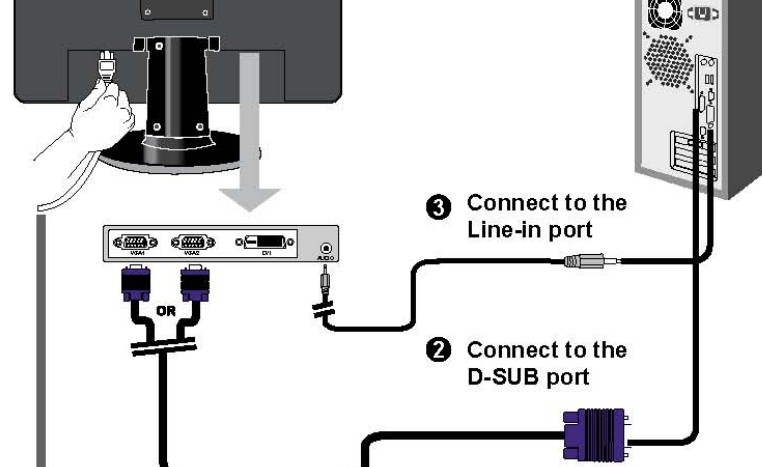

Irene Posted January 2, 2010 Report Share Posted January 2, 2010 I passed on my previous Sony Vaio PCV-RX407 to my daughter, to act as a 'Home Server'. She also has a ProView monitor, which has speakers on each side of the screen.Having connected everything together, she now finds that there is no sound from the speakers. In the master controls, all volumes are full, none are muted. We believe that all of the cables are correctly installed.Anyone any ideas? Quote Link to comment Share on other sites More sharing options...

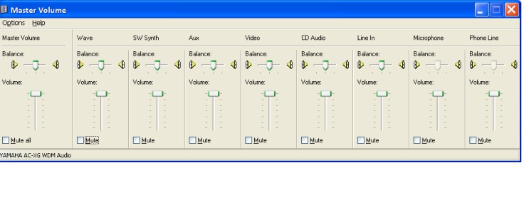

Irene Posted January 2, 2010 Author Report Share Posted January 2, 2010 I'd be inclined to recheck the audio cable, is it connected to the correct port, green I believe, so easy to plug the end behind the pc into the mic portAs catgate has pointed out onboard sound or sound card ?I believe that it is in the green port. She says that the sound is very faintly there in the wav adjustment. When the Line-in, Microphone & phoneline are viewed, the last two are greyed-out. Quote Link to comment Share on other sites More sharing options...

stephmayes Posted January 2, 2010 Report Share Posted January 2, 2010 Hi allThanks for your replies. I think the bios setting are well and truely over my head. However if it helps, this is a captured image of the master volume when the speakers re plugged in to the microphone socket. The speakers do work however they are very faint. The only way I can control them is by the WAVE column to the left. Notice the mic and headphone socket are greyed out. I reckon if I could get the computer to recognise the last two i would be in the running to fix the problem.I have checked the speakers on laptop and they work correctly when plugged in.Do you think i should look at the sound card ? Is there a headphones check somewhere as the headphones work correctly when plugged into same socket Quote Link to comment Share on other sites More sharing options...

rong Posted January 3, 2010 Report Share Posted January 3, 2010 Do you have the volume control on the right of the task-bar? if so right click and chose Open Volume Control, is there anything in thereThis is what I get with on-board sound with external speakers, I'm sure its the default My speakers are plugged into the green socket on the back of the computer Quote Link to comment Share on other sites More sharing options...
stephmayes Posted January 3, 2010 Report Share Posted January 3, 2010 The only difference I had with above images was that the mute wasnt checked. Done that. Still no joy. Really need sound coz my partner is studying for promotion and part of the study program at home is listening to audio CDs. Thanks all for your suggestions. This one really has us all baffled ! Quote Link to comment Share on other sites More sharing options...
